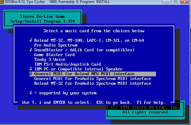

As far as your roland problem I am still trying to bend my head around as to what you are actually doing. Are you using a a real Roland Mt-32 and telling dosbox to use?
I have included a screen shot of the available option in my sierra installer. the one that is currently selected ("General MIDI...") is the one I typically use.
in that case, even when using TiMidity, everything loads almost instantly.
if i chose the 1st one (Roldand-MT32), the game takes about 15 minutes to load. I had actually thought that DosBox was not responding when i first tried this, and i thought I closed out the program and opened another dosbox session choosing "General MIDI" audio this time..
while playing my second dosbox session, i suddenly heard the into music from the Roland MT-32" audio session of dosbox!
other (newer) sierra games don't take quite THAT long to boot using "Roldand MT-32" audio, but they definately take more than a minute or two.
I'm just wondering why it takes so long for everything to load when i chose "Roldand MT-32" but not long at all (a few seconds) when I chose "General Midi"
In terms of TiMidity, do you recomed I use only 1 SF2 file at a time? i usually use 3 or 4, (2 of them are over 100 MB, 1 is 65 MB, and one is 20 MB) -- i wonder if my games would sound different if I changed the order the soundfonts? -- or maybe removed some of them?
    76.18 KiB
    2398 views

Reply 25 of 26, by Kreshna Aryaguna Nurzaman
Doesn't mean to necro an old thread, but still....
I also have problem with TWSYNTH (Timidity++ Windows MIDI driver), DOSBOX, and games that use MT-32/LAPC. Whenever I run a game that use Roland from DOSBOX, with TWSYNTH as Windows MIDI driver, the game doesn't respond at all. I thought the game (or DOSBOX) crashes, but after reading your post, it seems I experience similar problem - although I don't bother to wait for about 15 minutes. I think the wait time will be longer in my case, because I'm mostly using an Intel Atom netbook for my primary DOSBOX platform.
I also have Roland Virtual Sound Canvas, and when I'm using Roland VSC as Windows MIDI drivers, games that use MT-32/LAPC run without problem. Of course, the instrument doesn't sound as accurate as when using Munt. But the point line is: the problem only exists when using TWSYNTH as MIDI driver.
Recently, I tried BASSMIDIDRV as Windows MIDI driver, and games that use MT-32/LAPC can run - unlike TWSYNTH. Of course, the instruments don't sound right, but that's another thing. Well, maybe they will sound right with MT-32 SoundFont.
It seems TWSYNTH is the only SoundFont-based Windows MIDI driver that has problems with games that use Roland MT-32/LAPC, or am I wrong?
Reply 26 of 26, by HunterZ
At this point, I would highly recommend using BASSMIDIDRV for GM games and ykhwong's DOSBox SVN build for built-in Munt MT-32 emulation. This is what I currently have on my laptop (versus real SC-88 and MT-32 synths on my desktop) and it works fairly well.
