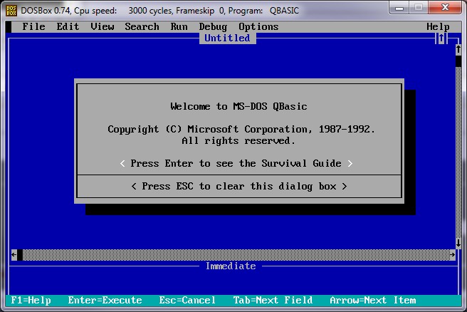

I assume you're referring to this:
FreeBASIC currently runs on 32-bit Windows, Linux, and DOS (a 16-bit DOS is good enough, although FreeBASIC itself and compiler output are 32-bit) and also creates applications for the Xbox console. More platforms to come.
That's so poorly-worded I think I might send them an E-mail. To be sure, I tried it just now and it most assuredly runs under 64-bit Windows.
Also for emphasis:
58.29 KiB
1010 views

Reply 16 of 16, by Jorpho
frusty wrote:
When I try my QBasic.exe file, which works in 32-bit systems, a message says 'this file is not compatible with the version of Windows you are running'. I've tried Windows compatibility modes, but they don't work either.
QBASIC.EXE is a 16-bit DOS executable and will never run under a 64-bit version of Windows without DOSBox or other software such as VMware.
Could you tell me how to get the welcome screen you showed in your post please?
I mounted a folder containing QBASIC.EXE as drive C, switched to drive C, and ran QBASIC, just like I said before. I really have no idea what you're doing...
