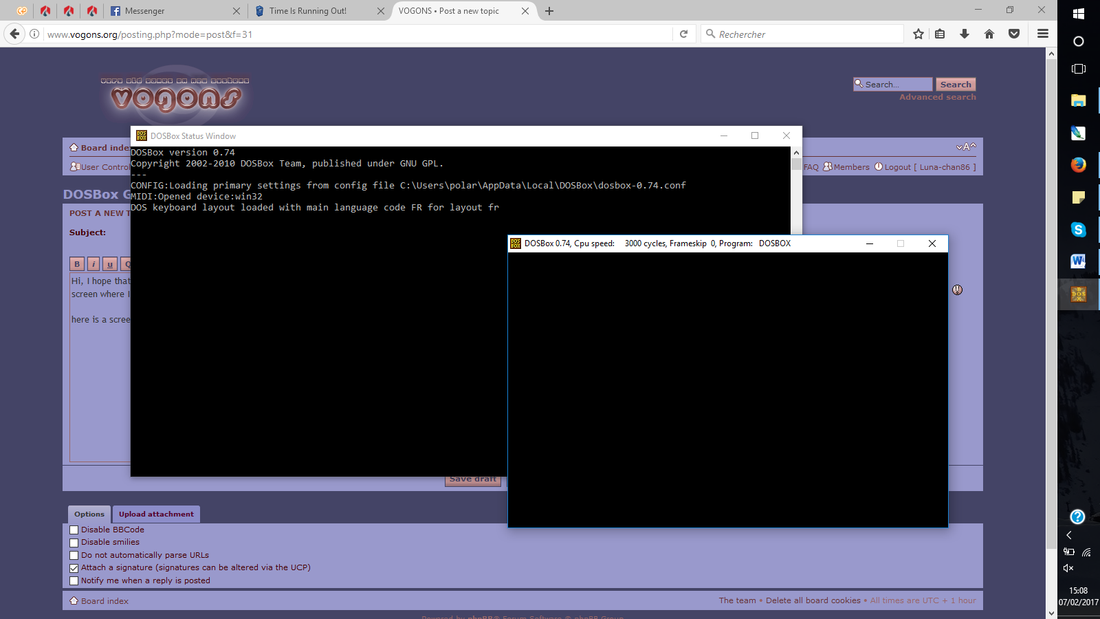

Hi, I hope that someone would be able to help me. I have bought a new laptop with W10 installed. I've downloaded the latest version of Dosbox and when I launch it, I have a black screen where I can't tape the mount directory, I can see nothing and the game seems to start but here too I can't see anything
here is a screencap of the problem:
https://i37.servimg.com/u/f37/11/92/04/26/screen10.png
Thanks for the help, here is graphic info: Intel Radeon 520
See ya and thanks very much
Reply 1 of 2, by Jorpho
Open your DOSBox.conf (most easily done with the "DOSBox 0.74 Options" shortcut that should be in your Start menu if you used the installer) and change the "output=" line to "output=opengl" or "output=openglnb". That will probably fix it.
