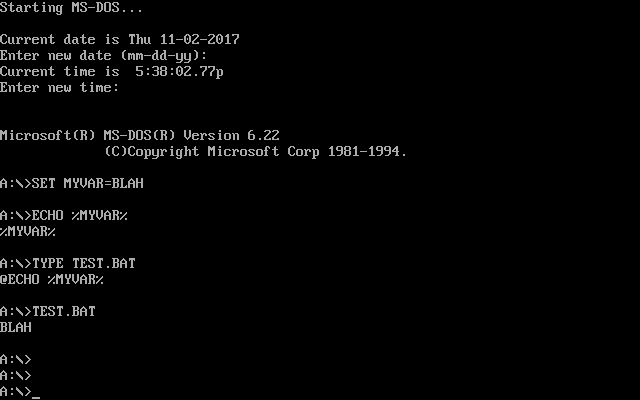

Osprey wrote:
I think that you'll have to use DOSBox SVN Daum, though, since this doesn't work in official DOSBox and even recent vanilla SVN builds ("echo %var1%" echoes "%var1%", not the contents of the variable). It seems ironic that, for as much as the devs say that SVN Daum is "broken," it gets right a basic DOS feature that their own builds don't.
Contrary to your criticism, inserting environment variables in commands does not work from the prompt in real DOS; it only works in batch files. So in terms of compatibility with DOS, official DOSBox gets it right and Daum does not.
Reply 7 of 17, by BitWrangler
Can't you just CD up the tree a bit before that line, reduce total length?
Huh? Swear I did it all the time in 6.0 through 6.22
Reply 8 of 17, by Osprey
That's a bit surprising and I don't have real DOS to confirm, but I was wrong about official DOSBox not supporting it in batch files. I was testing only at the prompt and not in a batch file. I just tested with a batch file and official DOSBox does handle the variables correctly there, which is a big relief.
Scorpion, sorry to lead you off in a wrong direction. You can probably put the Daum version and 4DOS aside, at least for now.

Reply 9 of 17, by ripsaw8080
Rank DOSBox Author
DOSBox Author
Well, if you actually have a use for the feature when typing commands at the prompt, it apparently didn't occur to Microsoft.
3.85 KiB
2135 views
BTW, since the OP seems to be compiling something, perhaps adding to the PATH environment variable would remove the need to specify some files on the command line.
