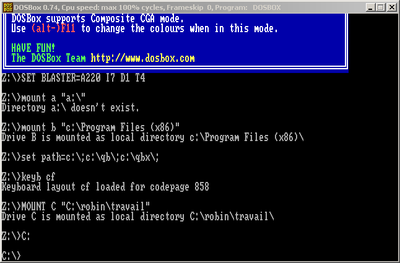

Is there a way to know when cycles is set to max?

I answered your question : Is there a way to know when cycles is set to max?
with regards to what you probably wanted to know. No, there is no way for you to know the value that is being used. (It changes at least 4 times a second anyway)

Reply 6 of 11, by nikiniki
I misspelled the question. Sorry
My question is how many cycles when I set to max?
Changing cycles to 70000 or max won't tell me how many cycles when I set cycles to max.
The dosbox manual says if you set cycles higher than the computer can run, dosbox will run slower.
I'd like to know how many cycles in dosbox my computer can handle.
Reply 7 of 11, by DosFreak
Depends on the application you run in DOSBox. If you set to max then it will not set cycles to higher than your computer can support so you're good.
If your application is still running too slow then you need to upgrade your processor.
There's no point in showing the value to a regular user since it would be pointless.
