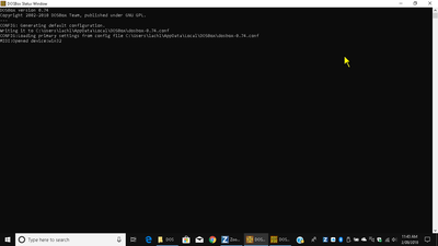

2) Can you enter the folder of where you installed Rise of The Triad (ROTT from now on), inside it, there should be a DOSBOX folder. Enter it
Now double click on DOSBox (the one with the icon) and 2 screens should pop up. (probably on top of each other)
Please take a look at the one with the title "DOSBox Status Window"
Please write down what is written there. (or make screenshot)

Reply 5 of 41, by Lachlant1984
Here's the screenshot of the DOSBox settings window.
Reply 6 of 41, by Qbix
Rank DOSBox Author
DOSBox Author
Alright, so the blocksize is not giving errors (which would have been displayed in the screenshot)
I'll pm you some files today (a replacement dosbox and replacement gog configuration file that works with that) to see if that helps.
