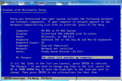

Then you'll be greeted by this screen:
71.41 KiB
1124 views
Change the Display option to the setting that says "VGA 640x480 with 16 colors". That's the only mandatory thing you need to do here. You can change things like the keyboard layout and the language options if you aren't an american like me, but leave the rest of them untouched.
Once you are ready to proceed, go to the option "The above list matches my computer" and hit enter.

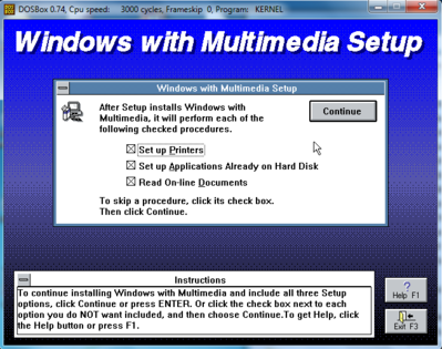

You'll now be greeted with the usual Windows 3.x style setup.
Click yes if you want to install the Multimedia Demonstration software. Otherwise, click no.
You will be greeted by this screen now:
76.87 KiB
1124 views
Select the options you want, I'll just uncheck them all. Press enter once you are ready to continue.

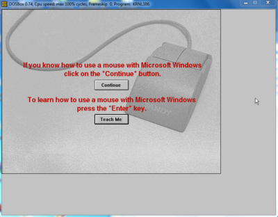

Now just type win and it will boot.
You should be greeted with this screen:
169.59 KiB
1124 views
Just click on continue. Click on no on the next screen and wait for the audio test to finish. If there is sound, then you did everything right. If not, go check the settings and see if you changed them appropiately.

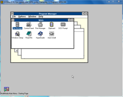

Once that is done, you should be greeted with the Multimedia Main Menu.
If you want to use Program Manager, just click on the corresponding option.
A dialog will pop up saying that if you want to make it the default shell. Accept it if you want.
And now you will be greeted by Windows 3.0 MME in all its glory!
