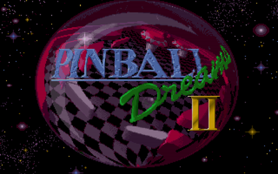

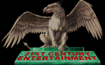

Reply 195 of 298, by Ant_222
FulValBot, Here is Pinball Dreams 2 running in my experimental implementation of Pixel-Perfect mode with OpenGL:
output=openglpp
scaler=tv2x
The screenshots show a 2x pixel-perfect scaling over a 2x TV scaler. Is it what you need?
    150.99 KiB
    4932 views
    80.2 KiB
    4932 views
    124.16 KiB
    4932 views
Reply 196 of 298, by FulValBot
Nice screens! Yes, i think that it's ok now (i'll check it with 1920x1080 resolution)
I don't know if more scalers are needed or not... (for example tv4x, tv5x)
for now i'll try it with scaler=tv3x (this for 320x200 games)
