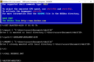

I am using the current version of DOSBox (0.74-3). My .conf file only contains a path= statement because, for some reason, when I launch DOSBOX a C drive is getting mounted automatically. It's the correct folder, but I didn't type a mount command from the Z: prompt and there is no mount statement in the .conf file. How is this happening? Should it be happening? What can I do to remedy it since I have other projects and don't want that particular path to be drive C in every instance?
I have checked my system for multiple copies of the .conf file, but the only one that exists is the one in AppData\Local\DOSBox. There is a second one in a different folder in Documents, but that one isn't even being detected (the mount statement in that one is from my old computer and has a different user account name).
Here's a screenshot. I added a mount statement to the .conf file so you would see that there are 2 mounts happening. The second one is the one I don't know the origin of.

I think I may have figured out what's happening. The batch file I am dropping on the DOSBox shortcut is located in the folder that is being mounted automatically by DOSBox. I think DOSBox looks at the folder the batch file is in as the "default" C drive and mounts it. Would that be correct?

Reply 7 of 8, by WayneCa
jmarsh wrote on 2022-09-19, 23:37:
If you launch DOSBox by dragging a file onto it, it does indeed automatically mount the directory that holds that file. Otherwise it wouldn't be able to execute it.
Now that makes sense, and I don't know why I didn't think of that myself. I guess it's just part of getting old. Thanks for giving me the answer I was looking for.
