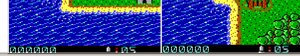

The change in CVS seems to break Secret Agent (I'm not 100% sure as my build is not clean).
    3.85 KiB
    3321 views
1+1=10
Reply 17 of 20, by ripsaw8080
Rank DOSBox Author
DOSBox Author
Hmm, split windows are found in more games than I thought. It's strange that some games work better with the bottom window shifted down a pixel (Pinball Fantasies for example), while others do not... this being another example. It makes me wonder how these splits look on real VGA hardware. Maybe there was a slight discrepancy between different VGA card manufacturers, and game developers tweaked their games to the hardware they were using... just a thought.
Same here. On a real pc the top line above the items (the black pixels)
is only a half 320x200-mode pixel high, and the bottom line as well.
Would have to double the resolution for that.
