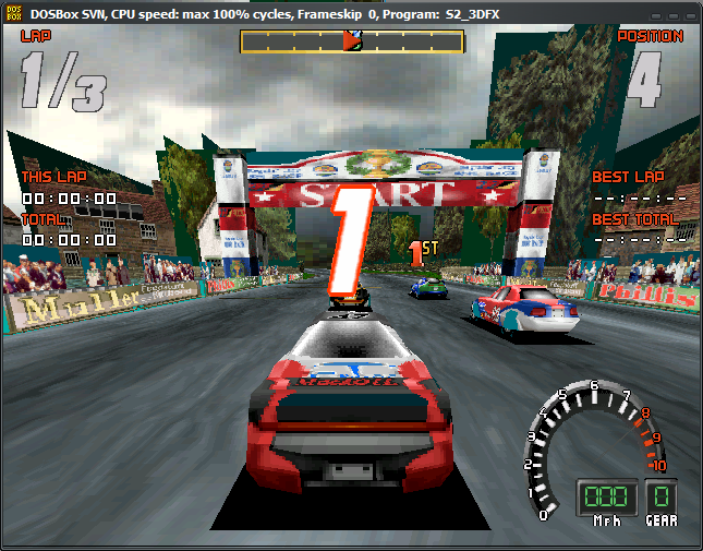

well, I just added a simple and not much optimized texture caching algorithm, and it's already going insanely fast 😀
there are still hundreds of bugs and many missing features
- proper opengl video mode switch
- simple non textured polys
- triangles z-sort(or zbuffer)/perspective correction/alpha/filtering/lighting
here's also the latest experimental patch (apply after patch voodoo_20101127.diff at page 10)

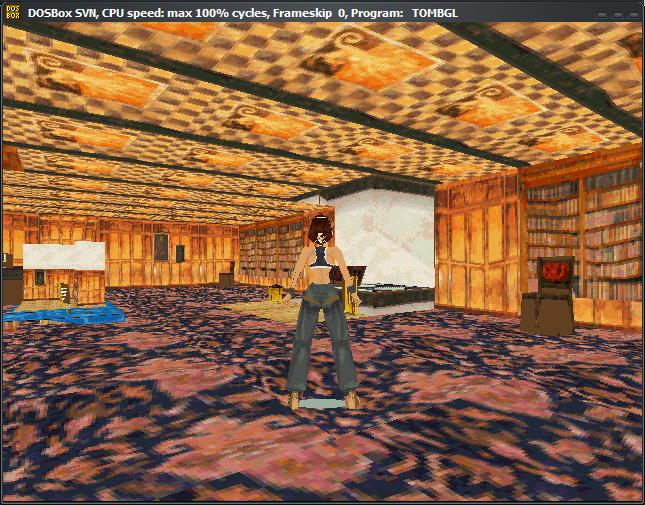

Reply 227 of 386, by kekko
I partially fixed texture alpha; need a hand from opengl experts with perspective correction/depth testing, I'm not sure on how to make it work. Any suggestion will be appreciated 😀

Reply 234 of 386, by kekko
I'm using glOrtho, and also
	glEnable(GL_DEPTH_TEST);
glDepthFunc(GL_LEQUAL);
glHint(GL_PERSPECTIVE_CORRECTION_HINT, GL_NICEST);
then when drawing triangles, I use glVertex3f(x,y,z), which is (mostly) working for depth testing, but not for perspective corrected textures.
I'm attaching the latest experimental code, with some preliminary depth testing and more stable videomode switch (thanks hal 😀 )
I moved all opengl code in the new include "voodoo_opengl.h"

Reply 236 of 386, by kekko
I took the values for z planes from openglide. changing these values seem to make things worse 😖
there are many textures, uploaded in the emulated texture ram; when the renderer calls a triangle for the first time, I upload its texture to the actual video card and then I link the emulated texture start address to a textureID, through a std::map container.

Reply 239 of 386, by gulikoza
One thing to keep in mind is that all (hopefully?) coordinates should already be pre-transformed. Voodoo did not have onboard transform&lightning (the first chip to have that was IIRC nVidia Geforce). Therefore, OGL should be set up in way to allow passing coordinates directly and not transforming them in any way.
Do you have a sample of where textures do not work correctly (a glide sdk test perhaps?).
ps. I guess video memory is not actually freed...you should check if any of the new textures overwrites an old texture mem address and release it then...
