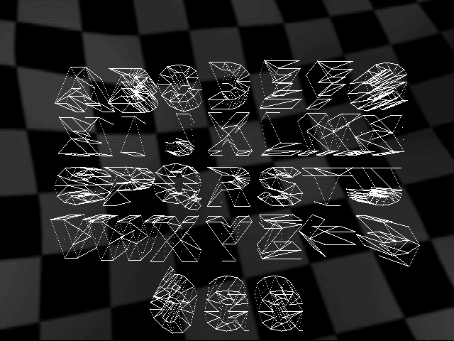

Reply 41 of 386, by kekko
I added a quick line renderer, just to start showing some nice triangle edges; there's still much to do, the code is a mess and many things are unimplemented.
I'm adding the sources, please don't look at the code quality...
And here you are, these are the first screens from the emulated 3dfx in dosbox! I just dumped the raw content of the frame buffer to disk; it would be nice to see it on screen. Have a look at the function swapbuffer in voodoo_func.h to have a clue on how it works.
The game is screamer rally.
    118.08 KiB
    9334 views
    20.76 KiB
    9334 views
    dosbox_20100908.zip
    998.35 KiB
    462 downloads

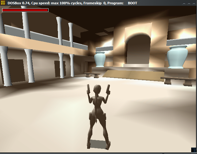

Reply 46 of 386, by kekko
the vga.mem.linear trick didn't work under dos of course, because of the different video mode, but worked great when I booted windows.
I managed to fix the page flipping and few other buffer bugs; now I'm playing tomb raider 2, rock stable, in wireframe mode.
About the rendering, I'm afraid that the mame renderer is not covered by bsd license, so it needs to be replaced.
So this is the status:
- the emulation is still unstable and at this moment it's "always on", that means there are data initialization issues
- not all the structures are correctly initialized or deallocated when a game is closed
- clut/gamma/otherthingsidontremenber are mostly not handled
- the renderer must be done from scratch
- a correct video mode switch handling should be implemented
- I simply ignored: timing, chip stall, vblank, retrace, other things mame does and I just don't do or didn't copy
- while glide games seem quite stable, few windows/directx games still crash and need further investigations (see tr3 or moto racer)
- tr1 gives a gp fault
- some aspects of the chip detection are not covered
about the detection routine, the tmu info detection relies on some routines that render triangles and then read the frame buffer (see sst1InitGetTmuInfo in the glide2x dll code), so at this moment it detects a random number of tmu units with 0mb memory each.
As you can see there's quite something left to do; any help in debugging, completing the porting, writing the renderer, cleaning up the code or in any other way will be appreciated 😀

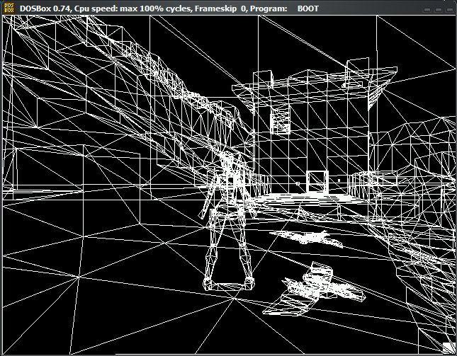

Reply 47 of 386, by kekko
I made some progress with the rasterizer; actually there are just a couple of functions that belong to poly.* and I'm just replacing them, hopefully there should be no license issue.
many games show from messed polys to blank screen, some seem to work better... Texture mapping is not working yet.
I'm having troubles understanding why textures are not rendered correctly while shading/clipping/z work fine (I'm tired...)
I'm attaching the sources as always, just in case someone feel like helping a bit.
Let me know if you manage to run it and if you discover something that may help to fix the bugs.
