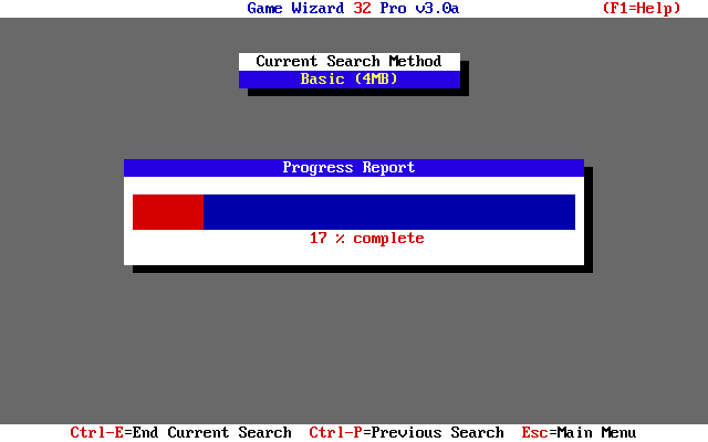

Hi!

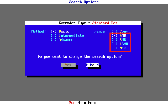

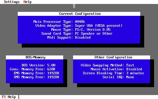

I have sucessfully installed and used GameWizard 3.0a, I have tried it for games and I am able to change lifes, energy, and these kind of things. This is using "Conventional" (Conv) as the "Range" in GW, but if I select any of the others "Range" options: 4MB, 8MB, 16MB or Max, DosBox allways hangs when it begins searching... I have tried it with different games and allways hangs.
Does somebody know why it fails or can solve it? I attach an image to see the "Range" option
I attach GameWizard 3.0a, decompress the zip file to get the .ima file. To mount it in Dosbox: imgmount a c:\dos\gwp30a.ima -t floppy
Note: I have disabled the Sound Blaster in DosBox config and executed the "gwsetup.exe" of the GW to save the changes to detect there is no Sound Blaster and use Speaker

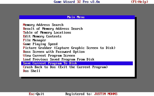

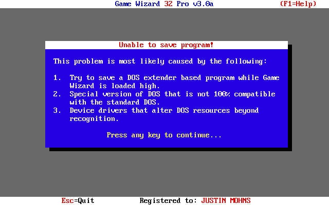

There is another problem. The "Save Current Program To Disk" option never works.

Reply 2 of 22, by Qbix
Rank DOSBox Author
DOSBox Author
i doubt that this is freeware to distribute.
Second. Why should this work ? It's not a game.

Reply 4 of 22, by Qbix
Rank DOSBox Author
DOSBox Author
well that commit might fix a game as well. I doubt that saving to disk will improve a game.
I think that if you boot a version of DOS inside dosbox that saving to disk will have a higher change of working than using our very own (very unusual) version of DOS.

Reply 8 of 22, by jomalin
I have investigated a bit the problem using the standard DosBox 0.74 debugger. Just before the hang this is what DosBox debugger shows:
DOSMISC:DOS:Multiplex Unhandled call 1605
CPU:CPU:LOCK
CPU:CPU:LOCK
CPU:CPU:LOCK
CPU:CPU:LOCK
CPU:CPU:LOCK
CPU:Illegal/Unhandled opcode 63
CPU:Illegal Unhandled Interrupt Called 6
And the last two lines (bold ones) repeat in a loop...
This is the line that causes the first error
(DOSMISC:DOS:Multiplex Unhandled call 1605):
F000:15C0 FE382E00 callback 002E (DOS Int 2f)
Looks like the call to int 2F having AX=1605 is not handled by DosBox.
This is the info about int 2f with AX=1605:
http://www.delorie.com/djgpp/doc/rbinter/id/15/45.html
Also, the other 2 errors:
0000:0024 6313 arpl [bp+di],bx ss:[0311]=152A --> this causes CPU:Illegal/Unhandled opcode 63
F000:1060 FE380300 callback 0003 (default) --> this causes CPU:Illegal Unhandled Interrupt Called 6

Reply 12 of 22, by ripsaw8080
Rank DOSBox Author
DOSBox Author
It appears to be making a questionable assumption when EMS is active that the call to INT 2F/1605 will return a V86 mode enable/disable callback address. That works in MSDOS with EMS provided by EMM386, but I wonder what would happen with an EMS board... Anyway, your success rate with this application will be higher in general if you boot real DOS in DOSBox, but you can work around this particular problem with ems=false.
Reply 13 of 22, by jomalin
ems=false solves the memory search hang, now works, thanks! But what consequences can have having ems=false to the games?
The other problem, "Save Current Program To Disk" option, doesn't works.
