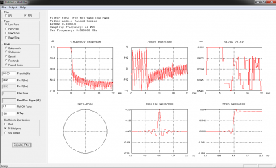

although It can be implemented in integer with a LUT for the sinc function.
This is exactly what Qbix is trying to do,, WinFilter can export C or VHDL code.
If everything goes smoothly, DOSBox will have awesome SB16 filtering emulation.

James-F wrote on 2020-01-09, 15:38:
I haven't worked with WinFilter, although the excess ringing and overshoot on the knee looks a lot more like a truncated sinc function without an optimized window. Windowed sinc also provides a parameterized transition band, so you can make a more gentle or steep transition depending on sound preference or accuracy needs. I've done similar data filtering (not on audio) by tapering the Fourier series before transforming back to the spatial set, but windowed sinc looks like a more shake-and-bake way of doing it. I'm just not sure if the performance budget is sufficient for this amount of processing. However, sinc also looks like it's fairly trivial to vectorize, so there are probably avenues to take for squeezing out enough cycles.
