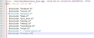

Reply 1044 of 1550, by Dracolich
inukaze, I also use Slackware64 14.2. Usually there is a separate download for (Linux source) which works fine, but I don't see one for the current version. A while back I made my own patch and shell script files to convert the (source). I used it on the newest version, 4346, just now and it still works. You're welcome to try it, or examine the files and see what it does so you can adapt it to your environment.
If you want to try it, copy both files to where your DOSBox ECE source directory, beside the autogen.sh and configure files, and run the .sh file. First it will try to copy gl.h from the standard location to your DOSBox ECE source directory, then it strips Windows style line endings from autogen.sh. Then it applies the patch file which modifies gl.h, pci_bus.cpp, voodoo_emu.cpp and voodoo_vogl.h to fix some Windows style paths and a few GL settings.
Note that if the files get patched and the build still fails you will have to replace the patched files before trying again.

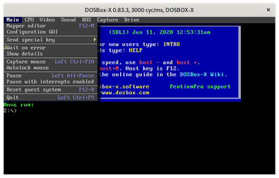

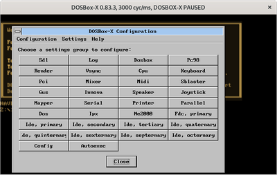

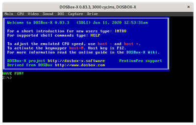

Reply 1058 of 1550, by _Rob
Starfox wrote on 2020-06-11, 10:08:
Hi,
Is there a Dosbox ECE build with Menu out there ?
I have SVN Daum build but this is outdated and some Games won´t run with it.
DOSBox-X has a menu.
