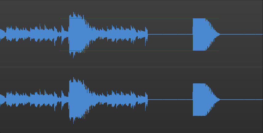

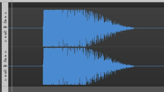

Here is an example of an explosion in Supaplex, it reaches full digital scale (but doesn't clip) WITHOUT any other source like FM music or CD audio.
Add FM music together with PCM sounds and you have clipping in DOSBox SDL, before it reaches Windows mixer.
Here is the very same explosion waveform (right) looks with "mixer master 50" together with some FM music (left):
Notice there is content above the red line when there is PCM and FM together, this content is clipped when DOSBox master is set to 100.
Some games will reach 0.0dbFS even with "master 50" because the FM music (or CD audio) and PCM sound together are loud, but this is rare.

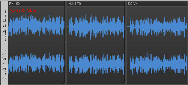

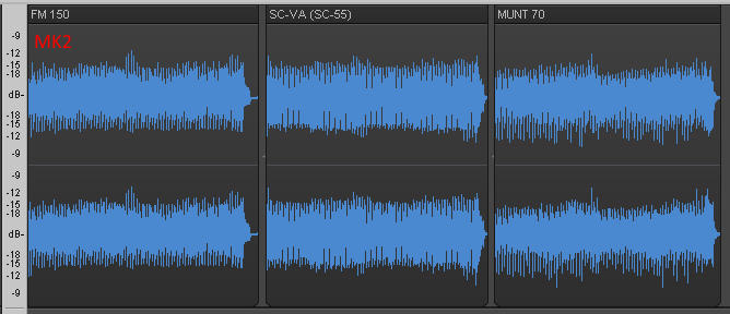

Here are some waveform of games that support all the formats:
I also tested Supaplex, DOTT and Monkey Island.
