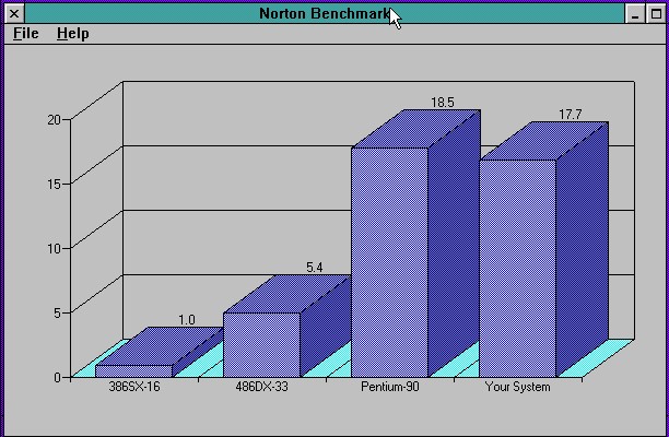

if anyone cares, here are two screenshots of benchmarks done with the last Norton Utilites for Dos/Windows 3.11 (I think it was 8.0).
The one that says in German "Dieses System" means of course "This system".
Both were done running on recent CVS, with dynamic core and cycles auto. My system is a P4 2.66 GHZ, 1 GB RAM. Also this built is using the svga patch and was running on 1024x768, so the bench could even go higher.
