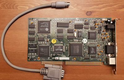

Here's a pic of the card. I'm pretty sure it's the Maxima model, but embarrassed to say I am not 100% positive about that. To be honest, I only learned about the ReelMagic technology about a month or so ago and was completely blown away by how friggin cool this thing is and how it would have been totally awesome to have a ReelMagic setup back in the day. (Also a bit surprised that no one has already created an emulator for this)
It has glitches on later cards with 8-pin pass-through outer cable (REALmagic Maxima, REALmagic Maxima Pro, REALmagic Ultra), and the latest ISA card (REALmagic Ultra II / NetStream 1, with 9-pin pass-through outer cable) has some problems with other games as well (while PCI cards do not work with any of them at all, of course).
Bummer 🙁 I guess we'll have to see what happens. If there are too many issues, I may have to try to scrounge up an older card that uses the feature connector. (oh no, anything but that 😀 ) Though we may also have to scrounge up a VGA card with the feature connector on it too... Any recommendations on VGA card to use with the original or Lite model?

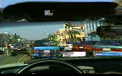

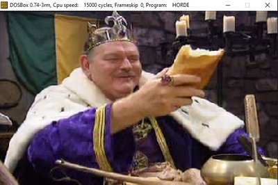

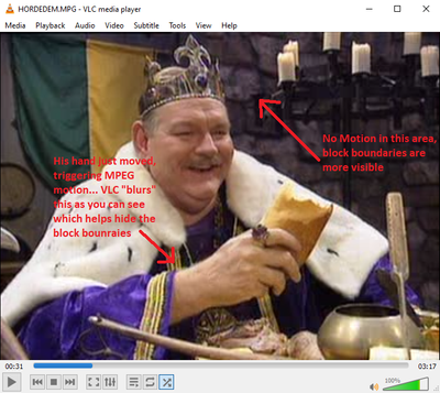

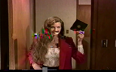

A little disappointed with video quality (holy macroblocking!) and low-res flickery backgrounds (also fmvs now), but its better than nothing!
Yeah there is definitely some improvement to be done here; a few known issues right now with regards to this:
  • The "just make it work f_code hack" I put it to get 90+% of the MPEG video working is certainly not complete and causes some video artifacts; most noticeable in the RTZ cliffs of depression.
  • The PL_MPEG decoder library itself may have some bugs in it causing some of the macroblock "color flashes" most notably at slice ends. (like the garbage you sometimes see on the right edge of the screen when the wizard is talking)
  • The roughness of the macroblocks and blocks can sure be observed as well; especially on modern high-resolution digital PC displays. I think that on the old CRTs this was less noticable. People weren't yet use to the HD glory we have nowadays and take for granted. SIF quality back then was (supposed to be anyways) the same quality one would have for their OTA analog television signal. It might be possible to get in an OpenGL shader which helps smooth these out yielding in a better overall picture quality.
Oh, yes, it is a 1995 Maxima card. I have it as well, but it is not the ideal choice, you know. "Return to Zork" won't work with it the correct way.
Some time ago I have collected and uploaded to Archive.org all the drivers I have: https://archive.org/details/sigma-design-drivers
Maxima has only a version 2.30 driver available.

Reply 36 of 172, by Bobbytoz
jrdennisoss
Thank you for the work done and detailed stories about the progress of development.
The update works with a modified The Horde disk!
But I noticed that the image is divided into large transparent squares. Which are noticeable in the dynamics.
    128.38 KiB
    2197 views

Bobbytoz wrote on 2022-03-04, 05:51:
Nice... Thanks for running that test again... Much appreciated!
The transparent squares you are seeing are indeed expected and part of the original video. They are the MPEG block (8x8 pixels) and macroblock (16x16) boundaries. The MPEG picture quality is slightly improved when turning on "VGA DUP5" mode, but you will still see theses in that mode too unfortunately. I attached a screenshot of roughly the same scene playing in VLC media player. You will notice that the block boundaries are harder to see in the places that have a lot of motion, but still visible in parts of the picture that remain fairly still. VLC media player applies some post decode digital filtering on the images which essentially "blur" the boundaries. The ReelMagic DOSBox emulator currently does not have this functionality. In the old days, when outputting MPEG-1 video through an analog format such as S-Video, these boundaries get naturally blended together as there is no such concept as a "pixel" with analog video, but rather things are separated per line, and the line boundaries are often blurred together by the phosphor in the CRT. Not now, but at a later phase I am thinking of implementing similar digital filtering like VLC does, but possibly in an OpenGL shader. Currently I am waste deep in figuring out the key to making the "magical" videos convert and play as normal MPEG-1 videos as well as game compatibility, but once I get past these major issues, I will definitely be looking at optimizations like this. 😀
    442.19 KiB
    2156 views
