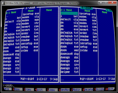

Reply 244 of 294, by James-F
It definitely works in SVN r4006 ECE.
Although, not my cup of tea...

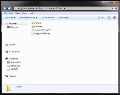

Reply 246 of 294, by James-F
Did you RTFM as specified by Yesterplay80? 😐
Place the glshaders dir where the capture dir and .conf are.
48.41 KiB
5182 views
Reply 247 of 294, by Laukku
I had the same problem, but after seeing James-F's screenshot and taking a closer look at the wording in the conf:
Note that in case it is used, the respective shader files must be found in the "glshaders" subdirectory relatively to where the default DOSBox configuration fiel is stored. For shader file naming convention, suppose that you have a pair of shader files ready: mysample.glslv and mysample.glslf.
I copied the shader folder to C:\Users\[User]\AppData\Local\DOSBox (default location where conf is stored) and now it works! Now the problem is that the interlaced shader interprets the image as interlaced video (i.e. removes every other line).

Reply 248 of 294, by Great Dragon
Laukku
Thanks. After copying shader dir to the default location it starts to work as expected. C:\Users\[User]\AppData\Local\DOSBox
This has to be added to a readme file. Because it's not very obvious and more over not very convenient to keep one part of files in your favorite dosbox dir and the other part in a system app dir.
Reply 249 of 294, by James-F
That's why I have a shortcut to the appdatat\local\dosbox\ dir in the more conventional DOSBox dir.
