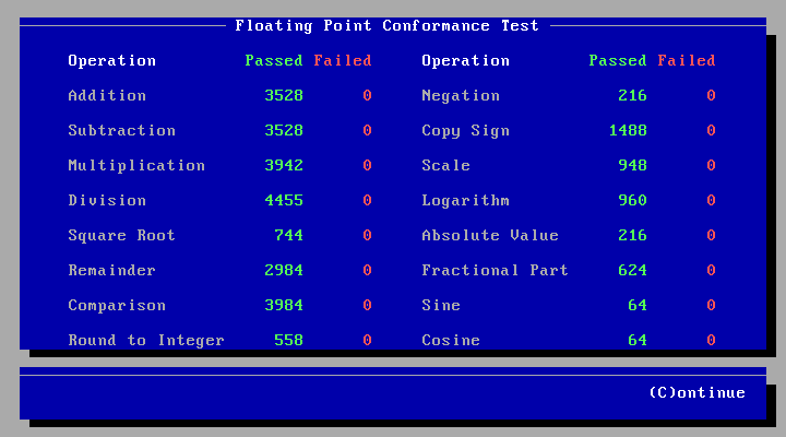

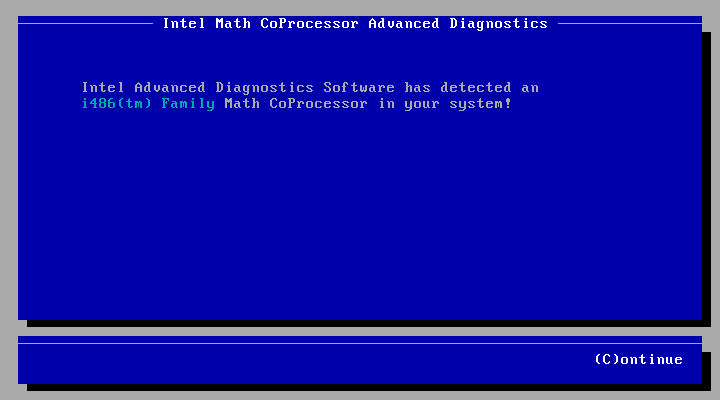

There are 2 versions of the Intel MCPDIAG program that seem to be floating about, with the same (c) dates up to 1991. One directly exits claiming no FPU found in DOSBox, the other does work.
As you can see, it detects a 486 with default DOSBox settings, so I would expect 487 checks, not 8087.
3.65 KiB
256 views
Running the conformance test (screenshot from a DOSBox fork, regular DOSBox has lots of failed tests).
6.91 KiB
256 views

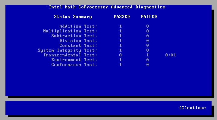

But running the diags, also the forks still have an error:
5.63 KiB
256 views
Reply 9 of 14, by ripsaw8080
Rank DOSBox Author
DOSBox Author
Results can indeed depend on core/FPU type or platform, but in my tests on Windows with 0.74(-3) and SVN, the MCPDIAG conformance test has no failures with dyn_x86/dyn_fpu_dh and 35 failures out of over 900 Scale tests with normal core -- not what I would characterize as "lots of failed tests".
As for the diagnostic tests, the failed Transcendental test is:
fldlg2
f2xm1
f2xm1
f2xm1
The 80-bit result value that the diagnostic checks for is off by 2 ULP (unit of least precision) compared to the DOSBox result value, which is the same for both normal and dynamic core. The LG2 (log base 10 of 2) constant used by the FPU or rounding error can account for the difference. In any case, such a small difference would hardly be noticeable in applications and games, particularly if the 80-bit value is converted to a lesser number of bits of precision.
