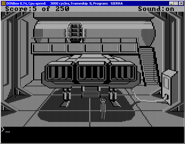

Here's my..."problem" (more like a "wish").
I dig the idea of emulating the CGA NTSC Composite Mode, but I'd like an option to turn the emulation off. 😳
Why?
I know it sounds silly, but back in the day I used to run Manhunter and other AGI Sierra Games on an old CGA machine.
The CGA pc was connected to monitor (not a tv set), so when I activated the "RGB Toggle" from the menu all I got was the 640x200 b&w mode with all the micro vertical lines.
Well, I liked it a lot, I liked that better than the plain CGA 4-color mode! 😁
I hope no one will get offended by this request, because the multicolor CGA composite mode emulation was a great effort, but I'd really like to experience that b&w environment again (which is totally different from the Hercules mode, btw).

Well, you could run the games with machine=svga_s3 and force them into CGA mode with a command line switch, because the color burst processing only works with machine=cga. Normally you run them with SIERRA.COM, so use a command of "sierra -c" to force CGA mode. Or, if you've decrypted the AGI module into AGI.EXE, use "agi -c". However, I don't know if you'll get mode 6 (640x200 mono) like you're expecting; some AGI games use mode 4 (320x200 4-color).

I don't think timing will be a problem; but 640x200 mono is wanted for "nostalgia" reasons, and the games I tried set mode 4 and change to B&W with CGA hardware registers, which won't work in other machine types.
I think the desired effect can only be achieved by changing the DOSBox source (see attached screenshot); but in this case the price of nostalgia might be eye strain. 😉

I've tried that, but unfortunately Manhunter switches from CGA green-brownish-red to magenta-cyan-black and viceversa. What the-? Isn't the "RGB toggle" supposed to activate the CGA Composite mode?
I'm lost, but I swear I saw Manhunter running in the way Space Quest runs in the screenshot ripsaw posted.

You get 4-color mode with VGA machine types because the games use CGA hardware registers to switch from 320x200x4 to 640x200x2. I achieved the effect by changing the DOSBox source. Change VGA_SetMode(M_CGA16); to VGA_SetMode(M_TANDY2); in vga_other.cpp; and you'll have exactly what you're looking for (deactivated color burst mode) with machine=cga.
