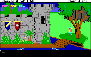

Hello,
I'm having difficulty with graphics when using DOSBox 0.74 in Tandy mode on my PowerBook G4 (Running Mac OSX 10.4.11). Specifically, I use machine=tandy to hear the 4-channel audio on old Sierra AGI games. This has worked fine on my PC, but recently when I tried doing it on my Mac, I get vertical scrambling when the game loads (an example is attached for Kings Quest 1). The scrambling also appears for other games as well (e.g. Railroad Tycoon running in Tandy mode).
I downloaded DOSBox 0.73 and the problem is also present there. As I mentioned, the games seem to run fine on the PC version of DOSBox (using machine=tandy), and the text mode (i.e. the DOS prompt) shows no problems. The video issues go away on the mac when running in svga_s3 mode.
Below I have included what I think are the relevant lines in my dosbox.conf file. This is the simplest resolution/scaling I can think of, but the defect appears for higher quality settings as well.

    Screen shot of KQ1 on Tandy system.

Back to the point, if it is an endian issue it would be straightforward to fix, since presumably the same code already exists in the svga_s3 emulation (which reproduces the graphics correctly). On the other hand, I would have thought much more serious problems would have arisen if the chipset emulation was off in this way.

With machine=tandy the AGI games use the 4BPP line drawing, which looks to be working with bytes.
Have output options other than surface been tried? There is endian stuff in sdlmain.cpp, which might be a good place to investigate if the issue is limited to certain output types.

Attached a patch with logging of the video memory vs output values. They are logged to the console.
Go to the screen that is depicted above and post one line.
On x86 the line looks like this:
vram 00,0f,f0,00, output 00,00,00,0f,0f,00,00,00
