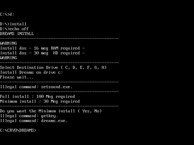

Description of problem:the install fail. see the attachment
Reproducibility of problem: Always

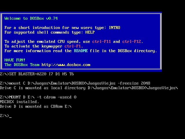

Video mode: the default of dosbox
Version of emulator: dosbox 0.74
    46.84 KiB
    2244 views
    This is my mount options
    32.65 KiB
    2248 views
    this is what hapend when i want to perform the installation.
Reply 1 of 3, by Dominus
Rank DOSBox Moderator
DOSBox Moderator
Try much smaller hd size, only thing I can think of.

Reply 2 of 3, by robertmo
this game's installer requires xcopy.
you can grab one from freedos or use ykhwong dosbox build that already has it built in.
a question to dosbox devs, why cannot you build in xcopy into dosbox the way yhkwong did it?
btw xcopy is in ms-dos since ms-dos 3.3
