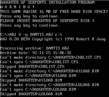

Reply 3 of 4, by robertmo
I think that is cause dosbox doesn't support making multiple directories:
eg. md folder1\folder2\folder3
I had simmilar problem when trying to install "daughter of the serpents" - I just had to install it in windows cause it was trying to extract .arj files and every file had a long folder tree so none of them extracted in dosbox
