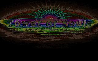

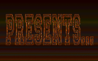

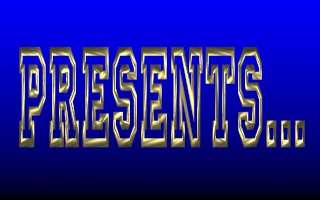

FWIW, I added a SET BLASTER=A220 I7 D1 T4 to a dummy AUTOEXEC.BAT in my DOSBox C: driver, and Tower of Souls started allright.
Something is wrong with the opening graphics though... After a short delay it displays a nice looking "PRESENTS..." in large yellow letters on a blue background (see snap 1). I would have expected this screen to be preceeded by a the name of company producing the game?
Next something weird happens to the palette (snap 2 and 3) before the intro runs, and the magic pen starts writing on the scroll, at which time everything looks fine.
I also tried running ToS in pure DOS with a dummy SET BLASTER in my AUTOEXEC.BAT, but it still completely locked up my PC. So DOSBox is a better DOS than MS-DOS 😁
