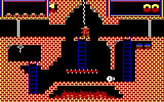

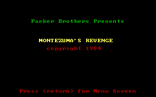

coolhaken wrote:
Montezuma's Revenge
Hmm? I was aware that this game checks for PCjr (at least some versions do), but IIRC only for keyboard handling, not for doing anything special with the colors. That'd be quite a curious find if it were true.
Reply 7 of 112, by coolhaken
The screen shot :
758 Bytes
6781 views
1.58 KiB
6781 views
Hex view of track 0 :
3.68 KiB
No downloads
