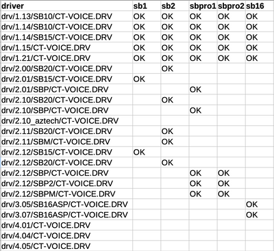

I've managed to produce a slightly more up-to-date table of CT-VOICE.DRV compatibility in DOSBox with various sbtype settings. My test was a simple program I cobbled together that loaded the driver and plays a VOC file if anyone's interested in it.
edit: The reason for my testing is that I had trouble getting digital sound working in Innocent Until Caught. The v1 drivers initialised but produced no sound. In the end I used sbtype=sbpro2 and the v2 drivers.

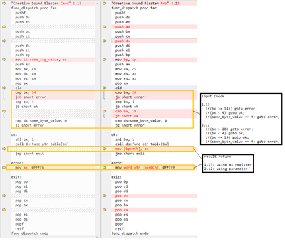

@sonneveld
i've disassembled the 1.13 and 2.12 CT-VOICE.DRV to see the differences between the versions
the newer versions seems to support more driver functions and has a different calling style to invoke driver functions (result return by ax or parameter)
this is the routine that gets invoked when someone far calls the driver
54.42 KiB
2401 views
the [bp+0Ch] overwrite in 2.12 changes data in the callers stack, so it could be that newer versions of the CT-VOICE.DRV can corrupt the game state a little (maybe too much)
if the game was developed with a older version of the driver - can someone confirm that finding?
so the stack for the function call needs to be at least
sp+0004 unknown/unused 8 bytes
sp+000C result offset
for example - this is a valid call to the driver if version 2.12 is used - if im not totaly wrong with my limited 16bit, stack knowledge
push 0
push 0
push 0
push 0
push offset result_var
mov bx,function_nr
call driver_ptr
add sp,10
mov ax,[result_var]
UPDATE: the 4.05 switched back to register ax as result, so its really needed to know the driver version before calling
and the code is all-in-all a little bit silly assembler code: for example: all variables get addressed by cs but every access to variables sets ds before to cs, instead of just accessing with cs:variable and also forcing ds segment
Reply 72 of 81, by llm
with the help from reddit/asm: https://www.reddit.com/r/asm/comments/vp65mu/ … rsed_dos_sound/
i've understood that the bp+0Ch actually targets the pushed ax register on stack - so the pop ax at end will contain the value comming from the called sub-function - is that typical asm code? looks a bit strange
so the 1.13 and 2.12 code is more or less doing the same and there is NO problem with corruption using newer drivers

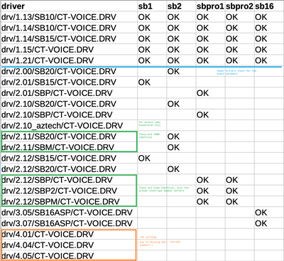

i've updated your matrix with my findings - the pre 2.x versions didn't check for the exact hardware - thats why the 1.x working for all combinations
some of the drivers identical, some got only minor differences like some bytes (base-adress etc.)
232.81 KiB
2306 views
nearly code identical, only base-address different and another port-adress, only 2 bytes different
CT-VOICE.DRV\2.11\SB20\CT-VOICE.DRV 3910  -> CT-VOICE.DRV\2.10\SB20\CT-VOICE.DRV
CT-VOICE.DRV\2.11\SBM\CT-VOICE.DRV 3910 -> CT-VOICE.DRV\2.10\SB20\CT-VOICE.DRV
