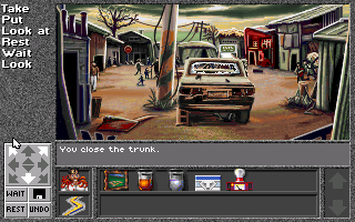

First post, by KainXVIII
Superhero League of Hoboken with LEGMPU works like a charm, but there is a strange problem - when i enter Jersey City Marketplace (just south-east from main headquarters) - there is no music at all in this location. This is with GoG version + latest Munt.
PS - when i switched from roland to adlib music appears on this location, is it like this on real hardware or its some kind of bug in emulation?

Reply 3 of 21, by ripsaw8080
Rank DOSBox Author
DOSBox Author
It's a bug in the floppy and CD-ROM versions of Superhero League of Hoboken. The game chooses not to play some of the MT-32 MID files stored in the MUS file because they have too many tracks. There are three MID files affected: two are easy to fix with a simple hack, but fixing the third is complicated.
Reply 4 of 21, by KainXVIII
ripsaw8080 wrote on 2022-07-06, 10:09:
Can you post this simple hack for CD-version? 👀
Reply 5 of 21, by ripsaw8080
Rank DOSBox Author
DOSBox Author
The size of the MUS file, and therefore the offsets where changes are to be made, vary from one version to another. So, instead of mentioning specific offsets, I will describe how to locate the offsets using a hex editor. But first, some description of what the hacking actually does.
The three affected MID files are named "Fight 1", "Fight 2", and "Fight 3". The first two have 12 tracks, the third has 13 tracks. There are four tracks of copyrite (sic) message at the end of the MID files which can be effectively discarded by reducing the track count in the MID file header by four. Reducing the first two MID files to 8 tracks brings them just under the limit of what the game will play. However, the third MID file with 9 tracks will still have one track too many, and if you go ahead and reduce the track count to 8 then the percussion track will not be played. In order to fully fix the third MID file, it would be necessary to merge at least two of its tracks together, which does not appear to be a trivial hack.
To perform the hack, search for the word "Fight" in the .MUS file, for which only three instances should be found. If you go backward 15 bytes from the "F" you will find an 0Ch byte (0Dh for "Fight 3") that you can change to 08h in order to fix that MID file; but as I mentioned above, fixing "Fight 3" in the described manner will lose the drum track.
Reply 6 of 21, by KainXVIII
ripsaw8080 wrote on 2022-07-06, 11:17:
Thank you, it works like you described!
