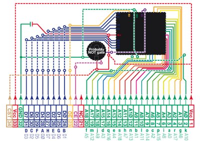

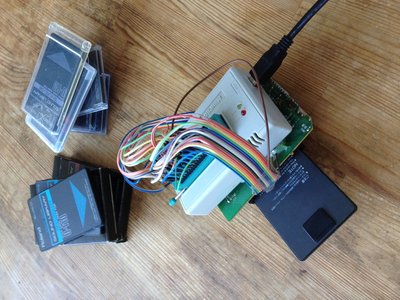

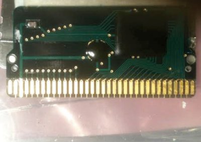

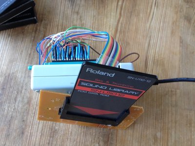

While the Sample ROM and Control ROM may be easy enough to dump, dumping the cards is going to be a tad more challenging.
I have dumped some of these pcm-cards I have to see if I could make some with my own samples, to play on my Roland U-220. I'm still looking at how Roland compresses the samples. That's how I stumbled on this thread. Because I hope that the algorithm Roland used to compress samples for the MT-32 would be the same as for the D-110, and maybe also the U-110/U-220. They are all from the same time period. And as the MT-32 is very close to the D-110, the CM-32P is hopefully very close to the U-110.
If I can help in any way, please let me know. I am more than willing to share my info and data.

I was looking at the "bit shuffling" part:
int order[16] = {0, 9, 1, 2, 3, 4, 5, 6, 7, 10, 11, 12, 13, 14, 15, 8};
And I was wondering: where this order information came from? Or what technique was used to see what bits are shuffled?
I am looking at the MT-32 Service manual and can't see any mismatching datalines. (at the moment)
Is the shuffling done inside the LA32?
@HunterZ, I am willing to share the data ("with people who have the cards themselves"), not that I don't want to share... But I don't want to get Roland on my ass for ©op¥right inƒring€m€nt.
