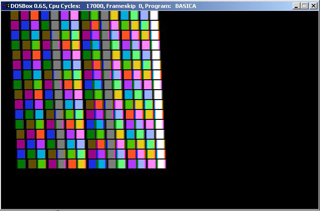

Lookie at all the pretty colors.
Did a test of the pattern generation needed to do composite colours.
Kiyote!
[EDIT]
@Dosbox authors
Do you want the actual code I've got that does this?
REM SWITCH VIDEO OUTPUT TO COLOR GRAPHICS ADAPTOR
DEF SEG=0
A=PEEK(&H410)
POKE &H410,(A AND &HCF) OR &H20
REM SWITCH TO MONOCHROME ADAPTOR
DEF SEG=0
A=PEEK(&H410):POKE &H410,A OR &H30
I know what you're thinking. Why change to the monochrome adaptor, then exit the routine? I dunno. I put both in that order in my *.BAS file, just to see if it would tickle the registers used to trigger the composite CGA. I didn't fix it since it wasn't broken, once I found out this worked in that particular manner.
In DOSBOX Dos, I've been able to run CMPOSITE.EXE once, enter BASICA, exit BASICA, then re-enter BASICA, with the COLOR BURST flag still set in local emulated memory.
This means, I'm on the right track.
I don't have a good classic game that uses composite cga to test this with. Used to,.. years ago.
Kiyote!
    40.13 KiB
    4529 views
    Screenshot of composite colors ~ coded in BASICA

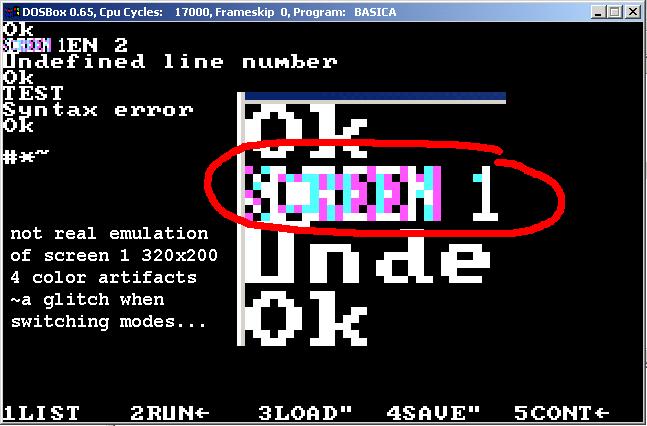

Maybe I'm missing the point of what you're trying to accomplish. DOSBox's CGA emulation supports composite color artifacting with 640x200x2 (mode 6) and the color burst bit just fine. What is lacking is support for the artifacted color with 320x200x4 (modes 4 & 5), and I don't think anything you can do from within the emulation is going to make it work, as the support has yet to be coded into DOSBox.
Reply 26 of 753, by KiyoteLockeWolf
Playing with it endlessly, I found out that you are indeed correct.
What I thought I was seeing as the 320x200x4 in composite mode, SCREEN 1 of Tandy BASICA, was actually a glitch that had the same look.
When I went from 640x200x2 composite to 320x200x4, it made some artifacts on the screen in the upper left corner. I thought it was actually in that mode.
Kiyote!
I have a picture of the glitch that I misinterpreted.
    51.83 KiB
    4419 views
    Glitchy 320x200x4. Not actual 320x200x4~composite mode.

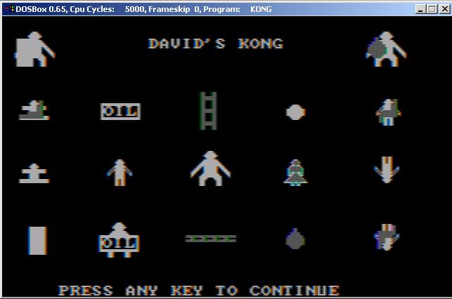

It shows this screen, on it's own accord, so it's not a bug.
Is this more of what you're talking about with CGA 320x200x4 composite mode?
Kiyote!
[EDIT]
<Sark> You're very persistant TRON!
BTW, after that lovely picture of weird 320x200xNTSC, the game locks up.
I think what someone needs to do is build up a CGA emulation TSR similar to the SIMCGA, that will draw the 320x200 in 640x200 so it can color artifact itself.
I think I might've finally hit the glass ceiling on possibilities with this little exercise.
I dunno what I did right to get the image that is shown there, but it did involve running multiple CGA/Herc/etc stuffs concurrently to try to overlap some of the emulation and stuff into something more like we want, as a *.BAT file. The screen went blank alot when I was testing SIMCGA, so I stuffed the commands into the *.BAT file so I could test without having to type blind.
    23.12 KiB
    4383 views
    Shot of original game graphics
    26.68 KiB
    4386 views
    Actual actions by DOSBOX to somehow simulate CGA 320x200xNTSC with a ton of kludging

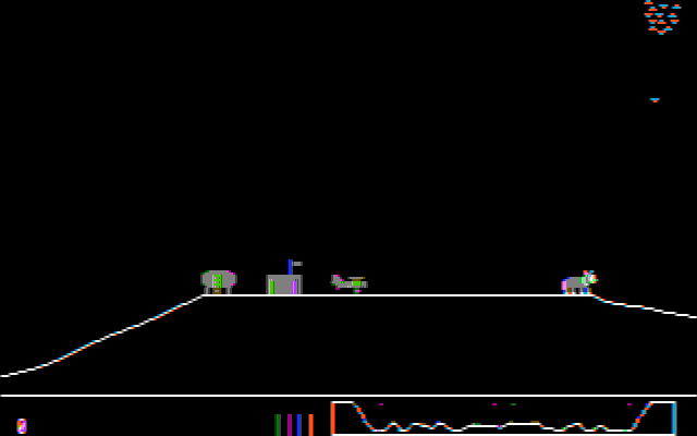

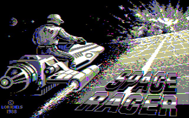

Using a TSR that requires a key press can be problematic, since some games take over the keyboard and don't let underlying programs (such as DOS) see the key presses. I figured it might be worthwhile to try a more automatic approach, and was able to get some nice results, although it's imperfect.
The attached TSR and assembly code is very quick-and-dirty, and basically monitors INT 10 watching for video modes 4 or 5 to be set, and then sets video mode 6 instead, afterwards flipping the color burst bit. It only works with the CGA machine type, of course. Quite a few games work with this, and display artifacted colors; although I couldn't say if the colors are correct. I've also attached some example screenshots. However, some games don't work; for example Alley Cat, which only displays a black screen. Still, it is somewhat surprising that it works as well as it does.
    13.95 KiB
    4357 views
    Space Racer
    1.51 KiB
    4357 views
    Sopwith
    8.21 KiB
    4357 views
    Sands of Fire (CGA)
    6.94 KiB
    4357 views
    Avoid The Noid
    COMP6.ZIP
    733 Bytes
    365 downloads
    TSR to convert CGA mode 4 & 5 to 6 with composite colors

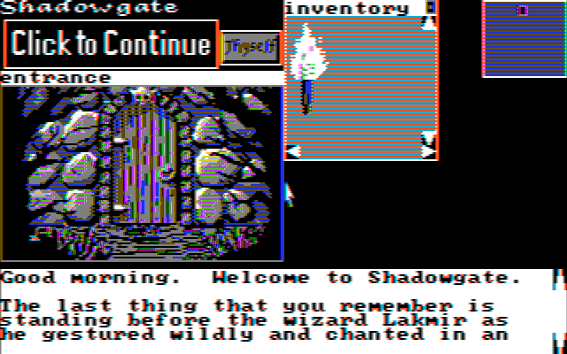

Reply 34 of 753, by ripsaw8080
Rank DOSBox Author
DOSBox Author

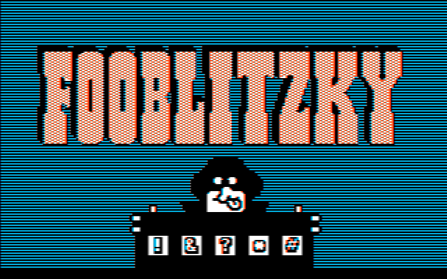

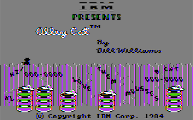

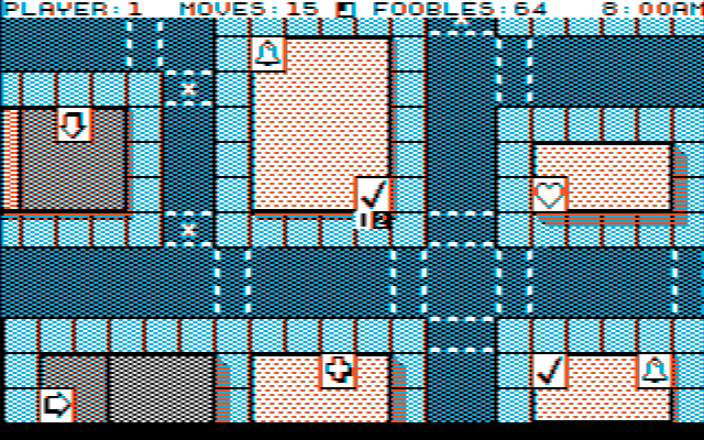

Some games check the video mode after they set it, so it's also necessary to report back the intended mode or they might think the mode change failed. Also, setting the background/border color was causing Alley Cat and some others to display a black screen, so I trap that now as well. The attached TSR has enhanced checking for the little issues, and now Alley Cat and Fooblitzky (the game this thread originally referenced) work with it. Alley Cat is showing some areas that are not artifacted, but it's kind of a dirty hack to begin with; can't expect much.
@Hierophant: This is just tinkering with a workaround. It is somewhat effective, but imperfect, and clearly no stand-in for real support... but hard to say if/when that will happen.
    7.97 KiB
    4322 views
    Shadowgate
    COMP6_2.ZIP
    967 Bytes
    373 downloads
    Enhanced version of TSR
    4.35 KiB
    4340 views
    Alley Cat
    2.05 KiB
    4340 views
    Fooblitzky title screen
    2.67 KiB
    4340 views
    Fooblitzky game screen
Reply 35 of 753, by KiyoteLockeWolf
@ripsaw8080
Quoted ~ "Still, it is somewhat surprising that it works as well as it does."
Are you referring to my TSR or to DOSBOX emulation? or something else?
@everyone else
Also, what was done to the code to upgrade the TSR? I noticed that in a post there's an upgraded TSR program.
All those screenshots are fresh and proof that our attempts are working?
Did someone get the 320x200xNTSC working?
I'm a bit vague on how much progress we have. Are we winnng?

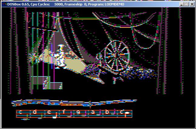

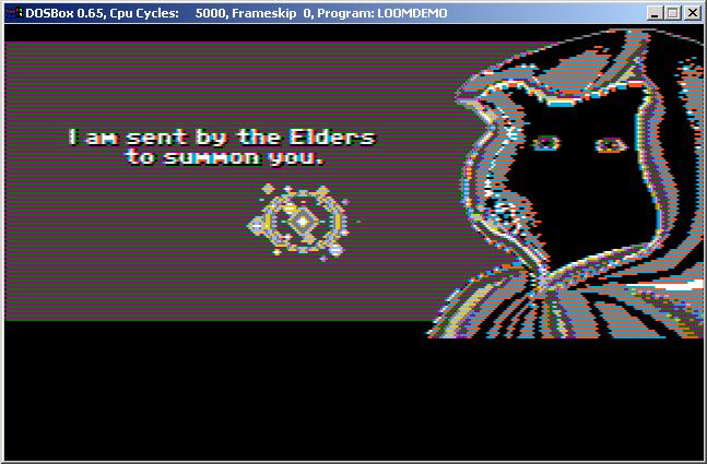

[EDIT2] Added screen shots of Loom (tm) autodemo.
    54.58 KiB
    4286 views
    Autorun Loom demo in CGA/NTSC
    64.34 KiB
    4286 views

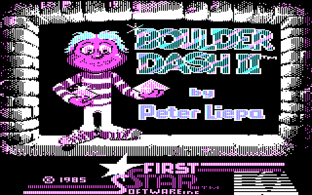

Reply 37 of 753, by ripsaw8080
Rank DOSBox Author
DOSBox Author

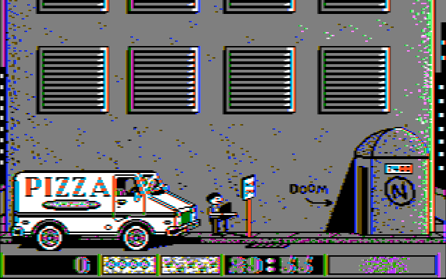

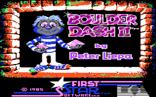

One thing a TSR can't do is monitor port writes, so games that write to port 0x3d8 are a problem. I had to hack Boulder Dash II to stop it from messing up the color burst so I could capture a composite screenshot. The BD2 title screen is a good example of patterns that are specifically intended to produce artifact colors on composite monitors. Although the colors are probably off from what they should be, it still demonstrates the effect pretty well.
    7.92 KiB
    4274 views
    Boulder Dash II title in composite color
    4.63 KiB
    4274 views
    Boulder Dash II title in RGB color
