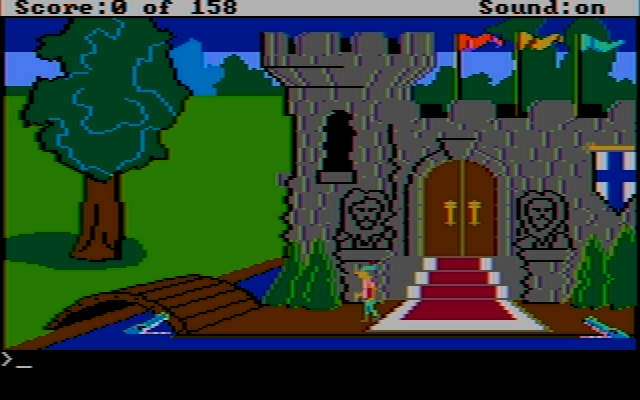

Reply 221 of 758, by nikiniki
It's seen like the dark cyan is swaped with light green.
Also, the gray color is darker and darker gray is black.
    5.77 KiB
    1745 views
    PCjr Version
    72.74 KiB
    1748 views
    King's quest CGA composite.

Reply 226 of 758, by NewRisingSun
reenigne wrote:
So the best we can do is to make it as objectively correct as possible (according to the relevant standards) and then provide knobs that people can twiddle if they aren't satisfied with the outcome
Okay, but a hue knob alone won't be enough to do that.
You would at least have to provide the user with the ability to decide the YIQ decoding matrix, preferably in polar coordinate form. NEStopia already does that. And if you're going to do the NTSC-to-709 correction, being able to choose input and output color spaces arbitrarily could also be added.
Of course, that's a heck of a lot of settings, which probably wouldn't be popular with developers to implement, maintain and mostly, explain in a documentation. (Implementation would be the least problem, as code for all aspects already exists.)

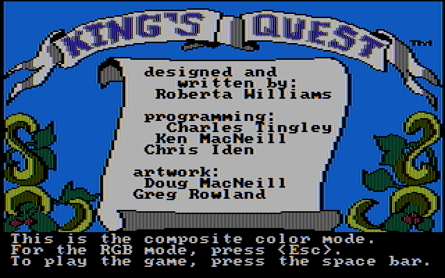

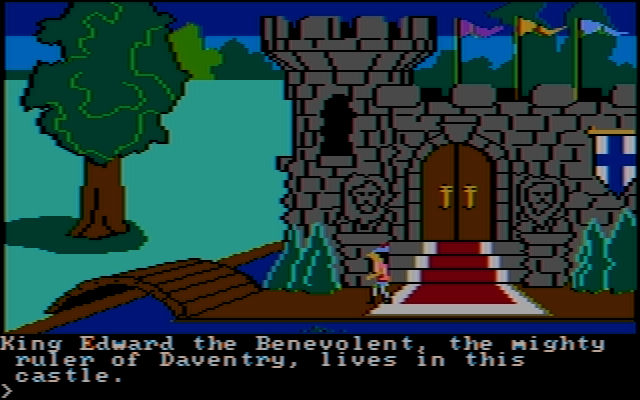

Please notice in the two pictures attached how the booter version and the 1987 AGI version differ in that regard. (I have adjusted the "pretty" matrix to make the grass less blueish.)
That's inherent with composite color artifacting --- there is only one gray. Actually, there are two grays, but they are of equal brightness. The only way to get a darker gray with composite color mode is to assume a three-line comb filter and alternate dark blue and dark green horizontal lines, which will be filtered to a darker gray by the comb filter. Consider the third attached picture.
    77.39 KiB
    1687 views
    73.69 KiB
    1687 views

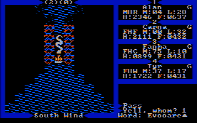

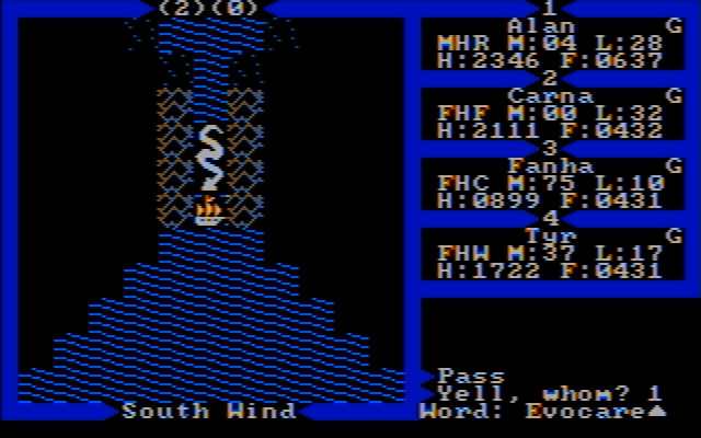

reenigne wrote:
and causes monitors which have them to turn it off
Has that been proven? I find it hard to believe that a comb-filter-equipped TV would bother to implement a detection of non-standard line rates just so it can then turn the comb filter off.
    35.29 KiB
    1658 views
    Ultima III without comb filter
    51.38 KiB
    1658 views
    Ultima III with comb filter

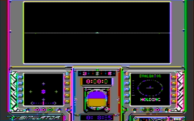

Blue Angels: Formation Flight Simulation uses the dark gray I mentioned earlier. I'll post screenshots later.

Reply 234 of 758, by ripsaw8080
Rank DOSBox Author
DOSBox Author
Blue Angels needs +140° hue offset in DOSBox to look similar to Servo's screenshots; the no-offset default colors are awful. That's a rather large adjustment when most games need little if any...
You can also see the filtered grays in Demon's Forge (link)
Reply 235 of 758, by NewRisingSun
Accolade evidently used a Tandy system to test Blue Angel's composite mode. The Tandy has a shift between the color subcarrier and the pixel clock of 135 degrees compared to the IBM CGA.
For what it's worth, as promised earlier, a picture from the game without and with comb-filtered grays.

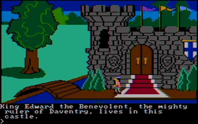

Reply 237 of 758, by NewRisingSun
reenigne wrote:
I think that happens because both Servo's capture card and your decoder are sampling the luma on the scanline and the chroma "in between scanlines" (i.e. the chroma comes from the output of the comb filter and the luma comes from the output of the notch/bandpass filter).
Not quite. See below.
reenigne wrote:
http://www.extron.com/company/article.aspx?id=ntscdb3 suggests that comb filters normally work on both chroma and luma which would make more sense for broadcast video since that gives you improved luma bandwidth
I'm not sure how reliable the information on those pages is. Why use a resonant bandpass filter at all in the comb-filter-less design? Why not just use a notch filter for chroma, then subtract the chroma signal obtained in that manner from the composite signal to obtain luma? That way, your luma signal retains the full bandwidth, and every single frequency component is either in luma or in chroma, never in both. Any artifacts remaining will be from misidentifying chroma as luma and vice-versa.
That's exactly the approach I use in my algorithm when disabling the comb filter, which is why the luma signal still is sharp, so sharp that 1010 gray still remains as such, as seen in the attached picture. In all other pictures, I deliberately blur luma to get rid of the vertical banding; but that has nothing to do with the Y/C separator.
For the comb filter, I would normally go about it in the same manner, subtracting the comb-filtered chroma from composite to obtain luma. Because my comb filter is not yet adaptive however, I don't do that, subtracting the notch-filtered chroma from luma instead to avoid hanging dots, and because luma is sharp enough as it is.
reenigne wrote:
and having the chroma offset from the luma by half a scanline would look wrong
Why is the chroma offset off by half a scanline?
    58 KiB
    1454 views
