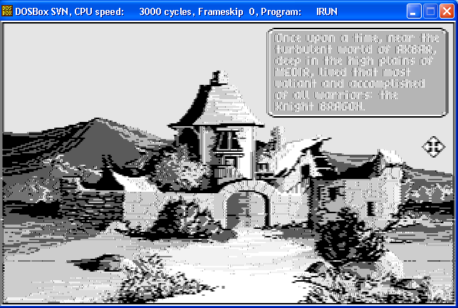

The Quest for the Time-Bird
something worth noticing - amount of shades of gray:

ripsaw8080 wrote:
Looking at the mode 4 palette, some of the colors have little difference in the two brightest levels. Perhaps there is excessive clamping at the upper end?
It's not excessive clamping - that's just the way the old CGA's composite generation works when the color burst is disabled: colours 1-6 become identical to 7 and colours 9-14 become identical to 15, so that text would not be legible with real hardware on a composite monitor either.
I think this is the main reason why the CGA hardware was revised - to make the shades of grey distinct for different colours on monochrome monitors.
I'm having trouble correlating what you've written to the point I made. For one thing, I'm looking at mode 4, which means color burst is enabled; and for another, I haven't mentioned anything about text. Perhaps another picture will make things clearer. In the bottom two rows of the attached palette image, many of the colors have little difference and so don't have a luma gradient at the upper end. It's quite different from the smooth gradients in mode 6, and gives blockier fringes when there is no difference in those gradient steps.
I don't know enough to say it's wrong, I'm just making an observation; and it may indeed be alleviated, at least to some extent, with more luma levels in a larger palette.
