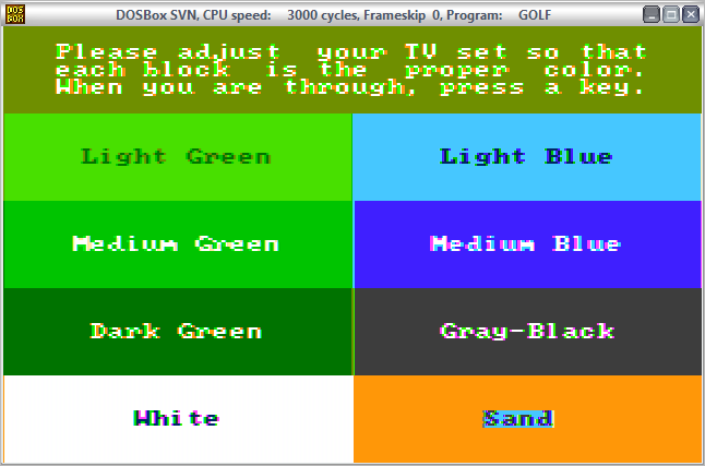

If that doesn't look like NewRisingSun's images then I don't know what he's doing.
I did try something like that, letting brightness be adjustable between 0% and 200% (which works out to -1 and 1 respectively when applied to Y):
Y/=4.0; Y+=(tv_brightness/100.0)-1;
but the result is somewhat different - see the screenshot attached.
NRS's images seem to fit in well with what was intended, at least going by the color names on the adjustment screen - e.g. white is still white, even though the brightness has been reduced. But with the above-mentioned method, reducing the brightness turns the white into a darker grey.
    15.62 KiB
    1865 views
    Hue at -35 degrees, brightness at -0.35 (65%)

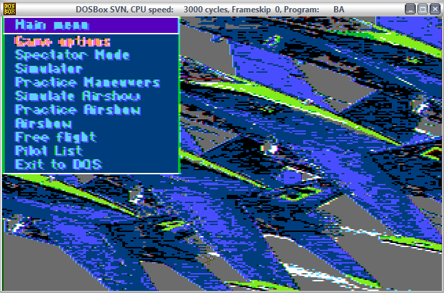

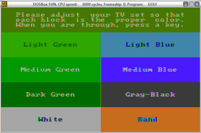

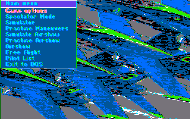

Patch is attached; here's what's changed -
  • "cga=old|new" is now changeable from the command line
  • flipped back the sign on hue_adjust (for consistency with current DOSBox)
  • brightness and saturation can be adjusted as follows:
    Increase brightness - Alt-F1
    Decrease brightness - Ctrl-Alt-F1
    Increase saturation - Alt-F2
    Decrease saturation - Ctrl-Alt-F2
These are just temporary key assignments. I don't know if I like having all of these functions in the mapper (for a finalized patch), but for now this will make it easier to test a big bunch of games and conclude how much control we'd really need.
    30.44 KiB
    1782 views
    Hue 135°, brightness 85%, saturation 60%
    15.63 KiB
    1782 views
    Hue -35°, brightness 20%, saturation 100%

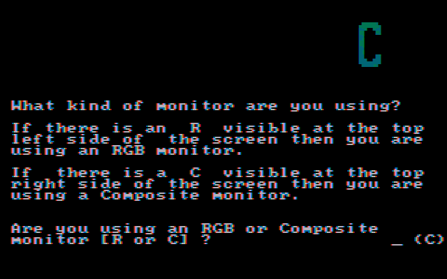

    7.45 KiB
    1450 views
    old CGA, saturation 60%, NTSC-to-709 adjusted, 7.5% black setup removed

Reply 414 of 753, by VileR
Thanks for sharing a proper build.
After doing some tests with the color-corrected new CGA, 70% seems to be an optimal saturation value: color clipping is mitigated enough to differentiate the two blue colors in Blue Angels; mode 6 and mode 4 games look fine, with minimal over/under-saturation (Tournament Tennis is sort of an extreme case, since it's a rare example of using the darkest palette available). Once again screenshots are attached.

Youtube has some PCjr video captures (1, 2) and the colors look virtually identical to New CGA with no other adjustments.... on the other hand, all the games shown use pure chroma colors so there's very little artifacting visible to put that theory to the test.
Another (minor) problem is that the auto detection won't work, since there's no such thing as port 0x3d8 on the PCjr.
