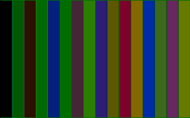

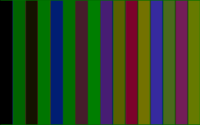

Ok, here's a few captures with palette 0 low intensity.
Great - thanks for these. Here's what it looks like in DOSBox using the aforementioned method (hardcoding a phase difference for the chroma signals and the opposite difference in the overall hue control). 115 degrees looks like a better match for your PCjr capture; still a few minor differences to work out.

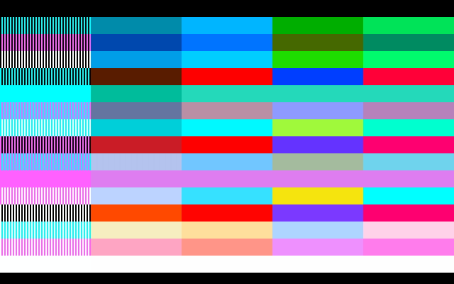

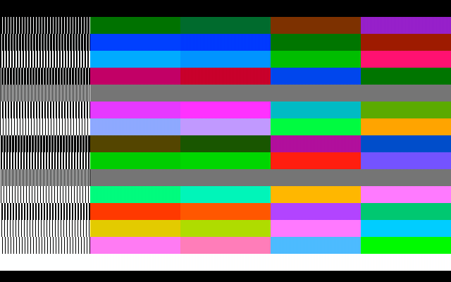

In preparing an overhaul of Wikipedia's CGA article to incorporate the new findings since 2008, I have created example images showing direct and artifact colors of all the major CGA revisions. I haven't seen a capture of the PCjr in 640x200 mode, so those colors might be completely off.
    2.13 KiB
    1524 views
    640x200 mode --- left to right: RGB, old CGA, new CGA, PCjr, Tandy
    2.11 KiB
    1524 views
    320x200 mode intensity palette 1 --- left to right: RGB, old CGA, new CGA, PCjr, Tandy
    2.17 KiB
    1524 views
    320x200 mode intensity palette 0 --- left to right: RGB, old CGA, new CGA, PCjr, Tandy

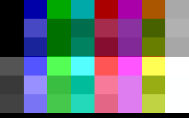

    1.88 KiB
    1525 views
    top to bottom: RGBI colors 0-7 on RGB, old CGA, new CGA/PCjr/Tandy; RGBI colors 8-15 on RGB, old CGA, new CGA/PCjr/Tandy
According to Servo's earlier post, 640x200 on a PCjr should be the same as new CGA with no offset (though that was from memory, so some verification would be helpful if that is to go on WP).
About those 320x200 PCjr palettes: intensity aside, some of the hues appear to differ from the captures; e.g. artifact color #2 being green rather than a reddish brown in both palettes, and #11 being a lot more yellowish in pal1. Though my DOSBox attempts above had similar discrepancies which I'm still not sure how to account for.
Reply 443 of 753, by NewRisingSun
I have updated the PCjr portion of the images. I had matched the PCjr to DosBox, now I have matched it to the captures. Palette 0 color 2 is now more like brown (though I would disagree about it being a "reddish" brown), and 640x200 mode now looks like new CGA.

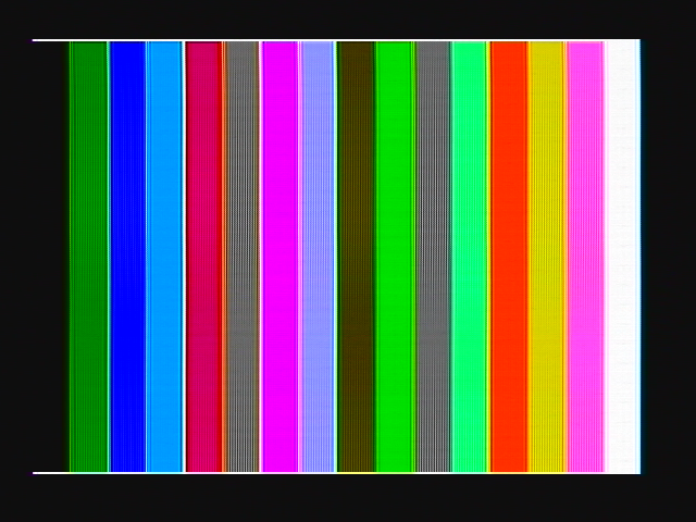

Reply 451 of 753, by Servo

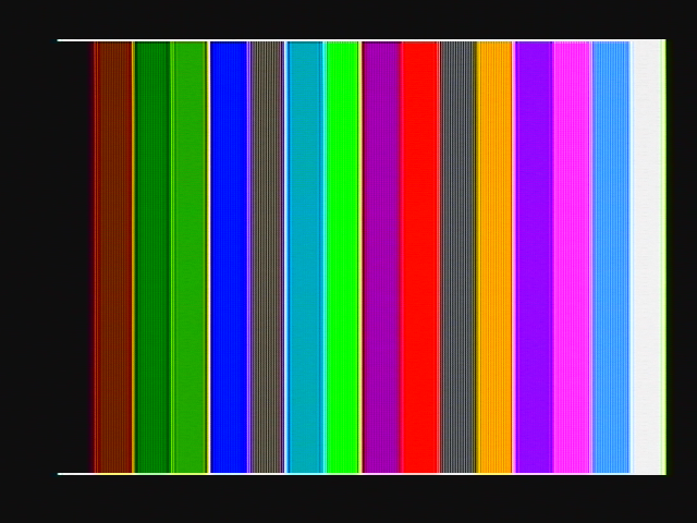

Well, once again my memory was completely off; I did a capture of mode 6 on my PCjr and on PC/CGA and the colors are pretty different.

Reply 452 of 753, by reenigne
Oh, fascinating! So the color burst phase relative to the pixel clock is completely different for the three machines PCjr, CGA and Tandy 1000.
That explains the inability to make the Below The Root title screen look right - because the hues of the artifact colours are shifted relative to the hues of the chroma colours, no hue shift will do the job - it needs a change to pixel_clock_delay.
I'll have a go at porting my chart.com program to PCjr but I don't have a PCjr so it might take me a few iterations to get it right.

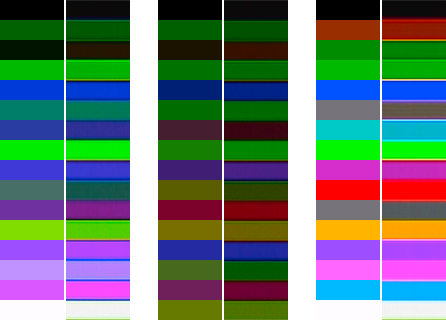

Hmm, thought I did something similar... if you look at my attempts, the solid colors (patterns 0,5,10,15) aren't shifted. Though I applied the offset to phases[6] rather than pixel_clock_delay.
Attached is a comparison of the results against the colors from the captures: the trouble with Below the Root seems to be that a select few colors are still off (see colors #2 and #9 in mode 4). Any idea what could cause that, if the chroma colors (and most of the artifact colors) appear to be correct?
    67.17 KiB
    878 views
    L-R: mode 4 palette 1, mode 4 palette 0, mode 6 color 15

Ah okay. In that case, three possibilities spring to mind - two easy to fix, one more difficult.
One is that just tweaking the hues of some of the artifact colours a small amount might fix things. Nybble 2 is red and black pixels, so maybe tweaking phases[4] a bit (while leaving the other entries of phases alone) would get you that reddish brown for nybble 2 without affecting the colour of nybble 10 too much.
The second is that the correct pixel_clock_delay might be different for 2bpp mode than for 1bpp mode.
The third one is more difficult - it could be that pixels start and end in slightly different places depending on their colours. In my patch I mentioned such a possibility in the comment "The pixel clock delay calculation is not accurate for 2bpp, but the difference is small and a more accurate calculation would be too slow." Well, maybe in this case the difference is large enough to be visible. The trouble is that without knowing exactly what the circuitry inside the PCjr's PAL is, there's no way of knowing exactly what those delays should be, and there's enough variables that tuning them all would be equivalent to just manually choosing a colour for each possible nybble.
