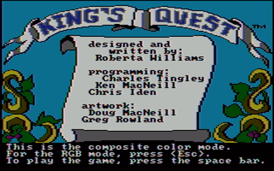

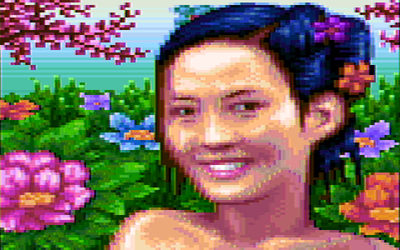

Reply 610 of 753, by NewRisingSun
The bright blue in King's Quest 1 CGA version is way too green at the default setting.
Also, I kind of expected a much sharper picture; in particular, the text seems much too rainbow-ish, even more so than the current DOSBox SVN. Compare the sharpness between the DOSBox build you just posted:
with my (non-DOSBox) decoder:
and Servo's (somewhat too dark and oversaturated) captured shot, captured from CGA installed in a Tandy 1000 (hence the different text artifacts):

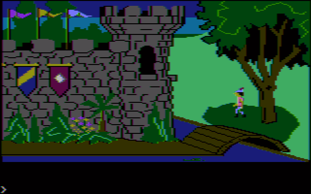

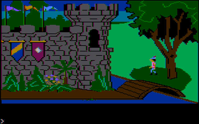

Reply 616 of 753, by VileR
Well, in current SVN the bricks have very blocky and prominent colored edges:
6.65 KiB
319 views
With the new patch (adjusted the hue somewhat), the edges are much less pronounced. You can see the improvement elsewhere, like the lack of spurious 1-pixel lines e.g. on Graham's cap:
10.78 KiB
319 views
