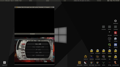

Can anyone tell me why after running CARMAV.EXE it opens in another window named "unnamed"? I cannot figure that out. I attach screenshot so maybe someone will be able to help me with it.

Reply 245 of 246, by Chewi
Try writing this to /etc/OpenGLid.ini.
Configuration File for OpenGLide
Info:
Priority goes from 0(HIGH) to 5(IDLE)
Output resolution: 0 = original, 1.0-16.0 = scale factor, >16 = fixed width (height calculated automatically)
Texture Memory goes from 2 to 32
Frame Buffer Memory goes from 2 to 16
All other fields are boolean with 1(TRUE) and 0(FALSE)
Version=0.09rc9
[Options]
WrapperPriority=2
CreateWindow=0
InitFullScreen=1
Resolution=2.0
EnableMipMaps=1
IgnorePaletteChange=0
Wrap565to5551=1
EnablePrecisionFix=1
EnableMultiTextureEXT=1
EnablePaletteEXT=1
EnableVertexArrayEXT=0
TextureMemorySize=32
FrameBufferMemorySize=16
NoSplash=1
Reply 246 of 246, by azn
Hmm, nope. It does not work and I had almost the same but without Resolution=2.0. Also I have mine in local directory as I install dosbox cvs locally.
It was all ok until I started writing the script. And the script is doing the same things I was doing manually.
Tried to start with clean dosbox-SVN.conf file but that's the same.
Still digging what could have gone wrong.
EDIT:
Still not quite sure what was wrong but the issue is solved. I recompiled both OpenGlide package and dosbox for x86_64 and as I am 100% sure they have both exact same versions compiled the same way. And somehow now it works as it used to before. In my opinion while working on the script I somehow ended with somehow messed up openglide version. Currently both openglide and dosbox are builded using my script and yet it is working ok.
