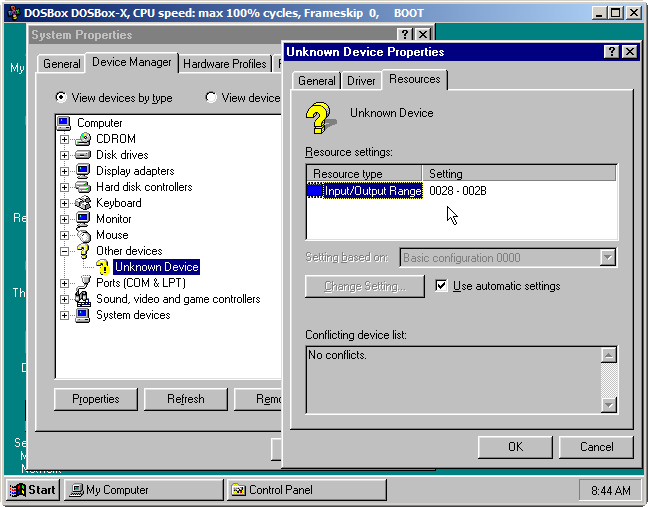

Reply 604 of 2397, by Laucian
What is this device? It appeared in revision 673. I've checked dosbox.conf and there's nothing using that IRQ.
    19.66 KiB
    993 views
Reply 605 of 2397, by TheGreatCodeholio
It's a test "just for the hell of it" device I added while fleshing out ISA PnP BIOS device enumeration. It was a test to make sure I was encoding I/O ports properly. I also thought that at sometime in the future I could make it a special "Windows 95 + DOSbox" integration device for things like mouse pointer integration or a system tray tool that triggers the CD-ROM swap function in DOSBox or something useful, kind of like what the Virtualbox guest additions drivers for Windows XP do.
I should probably make that an option that's off by default now that I think of it..
