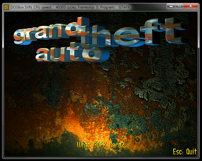

GTA doesn't seem to be fooled by this.
463.96 KiB
1130 views
Got the GLIDE2X.OVL in the PATH= I have set, the game finds it correctly, without it dosbox crashes.
Any idea?
Any idea?
Which glide2x.ovl is that? The version from a GTA 3Dfx demo seems to work (see attached file).
    glide2x_ovl_for_GTA.zip
    134.85 KiB
    173 downloads
    glide2x.ovl from GTA demo
