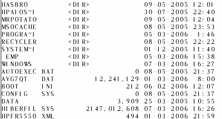

H-a-l, thanks for your patient support. Please help me with 2 issues:
1- I do not understand these "esc-p" commands: within the dosbox all I get is, after pressing esc, a "\" bar and if afterward I add p (which will only show a "p" on a new line without a prompt) and press enter, i get a message "illegal command: p.". What is the correct usage of these commands?
2- I did rename first the sansserif.ttf and later the roman.ttf font to courier.ttf (which became courier.old, oldcouriet.old, or just old) and restarted dosbox every time, but I still get the same printer output which does not even remotely look like courier (but if I print straight from DOS it's OK with Courier). Did I do anything wrong?

Reply 90 of 150, by asitnik
I tried renaming and even deleting the fonts leaving only the "renamed" courier.ttf, or another one. it seems to me that it works only when all fonts are both in the dosbox directory and in the dll directory (if any of them were missing, it would not print or it printed a blank page).
attached is a printout of a pdf output (yes, i used pdfcreator from sourceforge) to show the fonts that print - the only kind of fonts! it is irrelevant which printer i used - whether my brother laser, the hp deskjet, or pdfcreator.
note how the "temp" directory became " emp", and the grey band on the left is the edge of the page. any ideas what can i do?

Reply 96 of 150, by asitnik
Ykhwong, I am having a problem printing: the fonts, all of which are both in the dll and root folders of dosbox, do not work at all. What I get is some other font, which is way too ugly and is uneven.
I also noticed that if I remove any of the fonts it will not print at all.
Any suggestions?
Attached is a copy of the printout I get.
