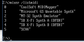

Reply 8 of 30, by KainXVIII
Dominus wrote:
Screenshot or it didn't happen 😀
Sorry!
    48.45 KiB
    895 views

Reply 12 of 30, by KainXVIII
Dominus wrote:
and it's the same when you are not in the NC shell?
Yes, i specially checked it without NC.

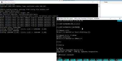

Reply 14 of 30, by KainXVIII
Dominus wrote:
And of course: does it work with lock stock DOSBox 0.74?
Proof 😀
    6.37 KiB
    886 views

Reply 17 of 30, by KainXVIII
Holy cow! I finally found the cause of why this patch is not working for me - i need to delete mt-32 roms from dosbox folder (and i even don't use builtin MT-32 emulation, only external MUNT)
Reply 19 of 30, by Dominus
Rank DOSBox Moderator
DOSBox Moderator
Yes, probably something like "if roms in folder x -> midi=mt32emu" to have less config settings but screwing up everything else. Or mt32 emu is enabled by default and failing without the roms and thus enabling normal midi again.
