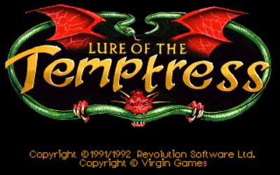

You can't eat the cake and still have it. xBRz, as well as any interpolation, must needs create distortion to fit the original image into non-commensurable display dimensions—and I am rather a purist preferring vinyl clicks and tape hiss to the artefacts of noise removal in music, and incomplete magnification to the artefacts of interpolation in DOS games.
Attached are examples of my algorithm at work with three settings of sharpness. A sharpness of 100% corresponds to nearest-neighbor interpolation so I have omitted it. The difference is easily noticeable at 1:1 scale.
    192.22 KiB
    1373 views
    sharpness=66
    206.34 KiB
    1373 views
    sharpness=33
    211.3 KiB
    1373 views
    sharpness=0
