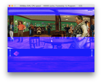

Solanacean, I now want to release a normal fix for the problem with the color layout instead of the crutches I made for you. Will you please test the attached patch? Checking surfacepp and surfacenp will be enough.
    RGBfix.patch
    84.06 KiB
    91 downloads

Reply 412 of 733, by Solanacean
Unfortunately, it won't build.
g++ -DHAVE_CONFIG_H -I. -I../..  -I../../include -I/usr/local/include/SDL -D_GNU_SOURCE=1 -D_THREAD_SAFE  -g -O2 -mno-ms-bitfields  -MT pixelscale.o -MD -MP -MF .deps/pixelscale.Tpo -c -o pixelscale.o pixelscale.cpp
pixelscale.cpp:593:69: error: ISO C++ forbids declaration of 'loopx_nb' with no type [-fpermissive]
( info* si, ps_rect *area, uchar* src, uchar* mid_row, rowstart* rs )
pixelscale.cpp:612:1: error: ISO C++ forbids declaration of 'loopx_np' with no type [-fpermissive]
make[3]: *** [pixelscale.o] Error 1
make[2]: *** [all-recursive] Error 1
make[1]: *** [all-recursive] Error 1
make: *** [all] Error 2
Reply 413 of 733, by Ant_222
Your compiler settings are more strict than mine. Will you please add return type void to the functions loopx_np and loopx_np:
static void loopx_nb
static void loopx_np
I will fix it my source when I come home.

Reply 415 of 733, by Solanacean
Not sure if it's worth mentioning, but if I minimize the window and then bring it back, I get this:
Reply 416 of 733, by Ant_222
Solanacean wrote:
Both modes are now completely glitch free! One thing though, is 320x200 game supposed to scale like this with output=surfacenp? […]
CONFIG:Loading primary settings from config file dsun.conf
MIDI: Opened device:coreaudio
Available area: 1440x900
Color data offset: 1
Scaling: 640x400 (1.00) --[2.2 x 2.2]--> 1440x900 (1.00)
Scaling: 320x200 (1.00) --[4.5 x 4.5]--> 1440x900 (1.00)
Available area: 1424x858
Scaling: 320x200 (1.00) --[4.3 x 4.3]--> 1373x858 (1.00)
What is the problem exactly—that PAR = 1.0?
It is. Does it go away when the screen is updated or does it stay? I might need to add some initialization to the pixel array... Edit: when you are having the bug, does log consistently say that the color data offset is equal to one?

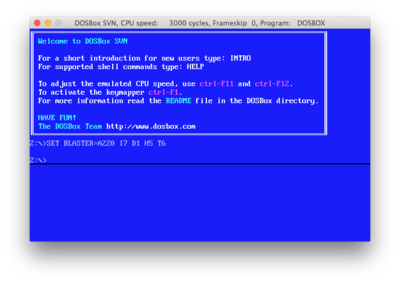

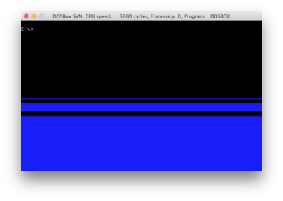

Reply 417 of 733, by Solanacean
Well, I'm not sure there's one, that's why I'm asking. =) There are no black bars on the left and right sides, the image fits the screen completely - is it how it's supposed to be?
It goes away completely after I switch to fullscreen, but if I don't, it stays like that. The attached screenshots show what it looks like before the screen is cleared with cls command (I assume that it should update the screen) and after.
Yes, it does.
Reply 418 of 733, by Solanacean
I've just checked - the same thing happens with output=surface.
output=opengl and output=openglnb are fine
With output=overlay the dosbox screen blinks for a second after I restore the minimized window, but apart from that, there doesn't seem to be any problem.
Reply 419 of 733, by Ant_222
