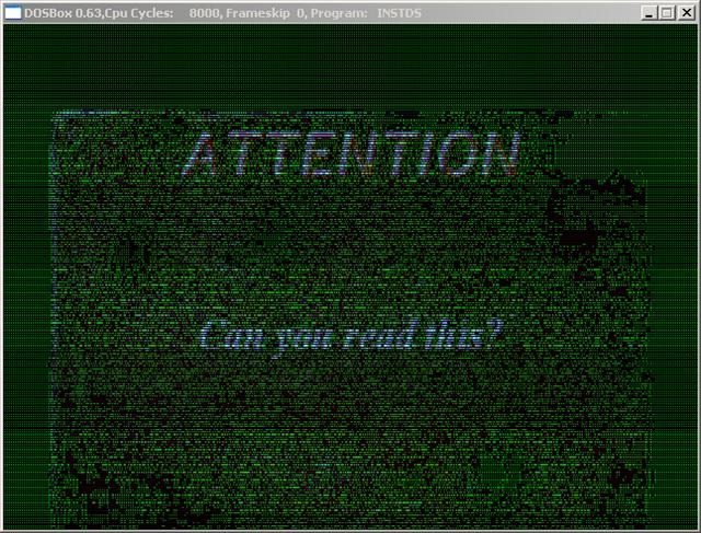

Since I have Radeon 9200, I cannot test OpenGL-HQ. But 16-bit VESA, which is part of this patch, should work anyway (at least I think so). But I have messed colors with a greenish look in the games that need 16-bit color mode - I tested Zork Nemesis and "D".

Jiri, I'll try and see what's wrong, I already have an idea (thanks to wd's observant eyes). Expect another patch soon.

Jiri, I updated the patches to address your problem. There's no updated binary yet.

16bit mode seems to work now...it's interesting, I didn't know tomb raider plays videos in 16 bit 😁 Haven't had the time to check openglhq yet...
