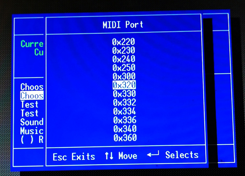

Windows dont find the Vortex.ini. But i found the au30dos.ini.
Look at the pic.

Reply 8 of 28, by Al_bundy
Ok, i have deactiveted the onboard devicec except paralel and serialport.
Sound FX Card works fine with standardsettings. But music card dont works.
If i select Soundblaster, i cant set the midiport. If i use general Midi, i can select the midiport. But not 310.
But both mididevices dont works.
Look at the pix.
Reply 9 of 28, by fosterwj03
Glad to see that you got Sound FX working.
You might need to set the "Vortex AU8830 MPU-401 Interface" manually in Windows Device Manager to "300-30F". Then select General MIDI at 300 in your game. If that doesn't work, try address 330, but it looks like that's reserved for external MIDI.
Otherwise, you can select "Adlib" sound at address 388 in the music options for OPL emulation.
Reply 10 of 28, by Al_bundy
I set in the device manager (Vortex AU8830 MPU-401 Interface) the 300-30F and selected the general midi in the game.
It dont works. -> could not detect MPU 401.
I cant select any adress if i select Adlib
Reply 11 of 28, by fosterwj03
Does Adlib work then (you might not need to set the address since Adlib defaults to address 388).
Check your AU30DOS.INI for the following parameter:
MPU401Base=0x300
If it's still 0x310, change it to 0x300.
You can also try address 330 in your game. That's the address of your real MPU-401 per the screenshots you posted in your first message.
