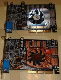

I've a couple of these I could dig out (inno3D Ti 4200 AGP 8X W/128MB AGP) - no idea on the other specs

Sorry for the delay; didn't have a suitable AGP rig to hand so had to throw one together!

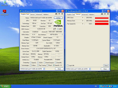

Have the bios images now (4.28.20.21.00 written by latest GPU-Z app...nvflash just wouldn't play ball?). I did both cards, but they're byte-identical anyway.

Tried various versions from 5.163.0 to 5.780, but none seemed to sit well with these particular cards for various reasons...GPU-Z worked first time.
So, grab em while you can 😀

Downloaded and burned. Seems to work so far but need to do some more testing. Thanks!
