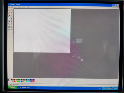

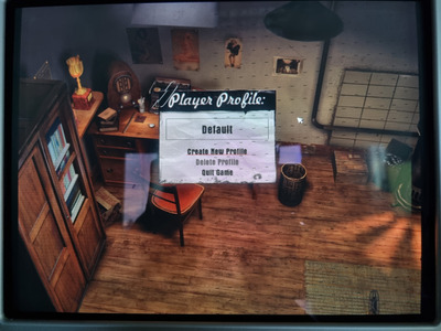

Only game I tried is Max Payne, and it has the same blue pixels during the game (Catalyst 3D demos have them as well while running on WinXP desktop).

Giantclam already identified it, but there here's what GPU-Z shows. For my surprise, the display started to glitch for about 5 minutes after I started the application, like the monitor trying to adjust itself.

Downloaded ATI Tray Tools, underclocked to the lowest value, but nothing changed. Even run the benchmark for artifact but shows nothing.

Any chance of trying some other OS? It might be possible to boot linux from a live CD. If the missing red value is still there then it's probably a weird hardware issue (some sort of internal palette mapping?).

that leaves
-gpu chip failed internally
-radeons keep framebuffer in fixed memory location and one bga ball failed under gpu/one of the rams lost one pin connection
You can try squeezing GPU and every ram chip with your fingers one by one while displaying some dynamic content to constantly refresh framebuffer.

If there was one bit not working wouldn't that show up as half the red intensities missing, either as a solid block (if the high bit was gone) or a series of bands?
Just had an unlikely thought: Since DVI supports both digital and VGA (DVI-I I think?), do we know for sure that the DVI test was definitely using the digital output? Maybe it's worth trying a passive DVI->HDMI adapter since I think HDMI was initially just DVI without the analogue bits, so it would guarantee that the digital output was being used. Maryoo's problem sounds a bit more odd in that it's only a problem on DVI and not VGA. Wonder if that might be cable/signal quality related.
I wonder if it would be possible to have a colour remapping tool that dithered the specific red value that's got the problem to one either side?

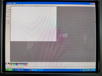

I let this problems sit for a while, and purchased a new Radeon 9600XT some weeks ago.
The new card producing black lines on the right part of the screen. These line occurs only in 3d applications, the winxp desktop is totally artifact free(but skipping to desktop with alttab keeps the artifacts on screen).
Running games in 16 bit color depth gives only a 5% part on the right filled with artifacts.
I tried a dozen Catalyst Driver, vga and dvi, 3 different monitors, even a winxp reinstall but nothing cured it.
Could it be the mobo agp slot?

How about maybe you need to fiddle a bit with the AGP settings - under BIOS? I would try this
Also please try good clean of agp. Maybe there is some little dust on m/b
and this motherboard is known for capacitors plague, maybe some caps need replacement?
It is also a good choice to try this gpu on different motherboard you got
Personally, I would try to clean the AGP slot with a vacuum cleaner first

Solution: purchased a third Radeon 9600 and it works perfectly.
So I have 2 9600XT with minimal artifacts. 🙁
