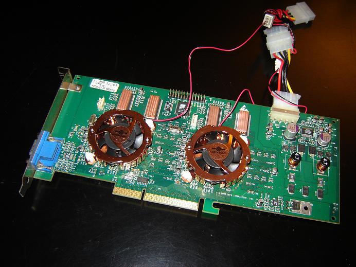

Okay, so I've got a Voodoo5 5500 here for my "Voodoo Rocket" build. There's just one problem. The bearings on these fans are completely shot. What would be the best course of action for replacement cooling? The stock heatsinks are pretty much crap, so I'm thinking possibly some beefy northbridge heatsinks?

The fans were very noisy on my V5-5500 as well.
I took them off, gave the heatsinks and fan blades a good clean, peeled the sticker off the back of the fan and lifted the small cap covering the bearing. Oiled the bearings with some sewing machine oil, and the fans quietened down a lot. Stil la little noise but I can't hear them when the card is inside a case.
Any chipset cooler should fit (you might need to use thermal epoxy to stick it on) but I don't know if I'd trust them with just a passive cooler, they do get quite hot.

I was thinking I'd use some appropriately sized new fans to go with the NB heatsinks.

You don't need much to upgrade the cooling on a v5 5500 and I used nb coolers on mine but reused two old thermalshield fans (3dfx logo) along with two zalman ramsinks on the back.
The best way for alternative cooling is to remove the STB heatsinks and then use some Vantec Icerbeq 4 coolers (they're pure copper and have quieter fans that spin faster):
These coolers use push pins and will work with the holes in the voodoo's PCB. So you don't have to use nasty thermal glue. Just apply some arctic silver thermal paste, pop the coolers in, and you're good to go!
Removing the voodoo 5500 heatsinks can be difficult (and DANGEROUS if you attempt to just pop them off with a knife, you can rip off the BGA chips), but I did a video on how to remove them safely with a can of compressed air.
