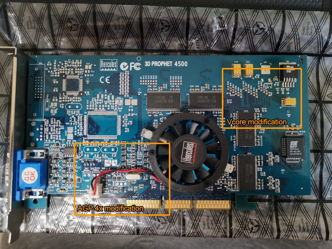

Here's the two hardware mods I had to do to the Kyro II to get it to play ball in the Shuttle SB51G Pentium 4 machine.

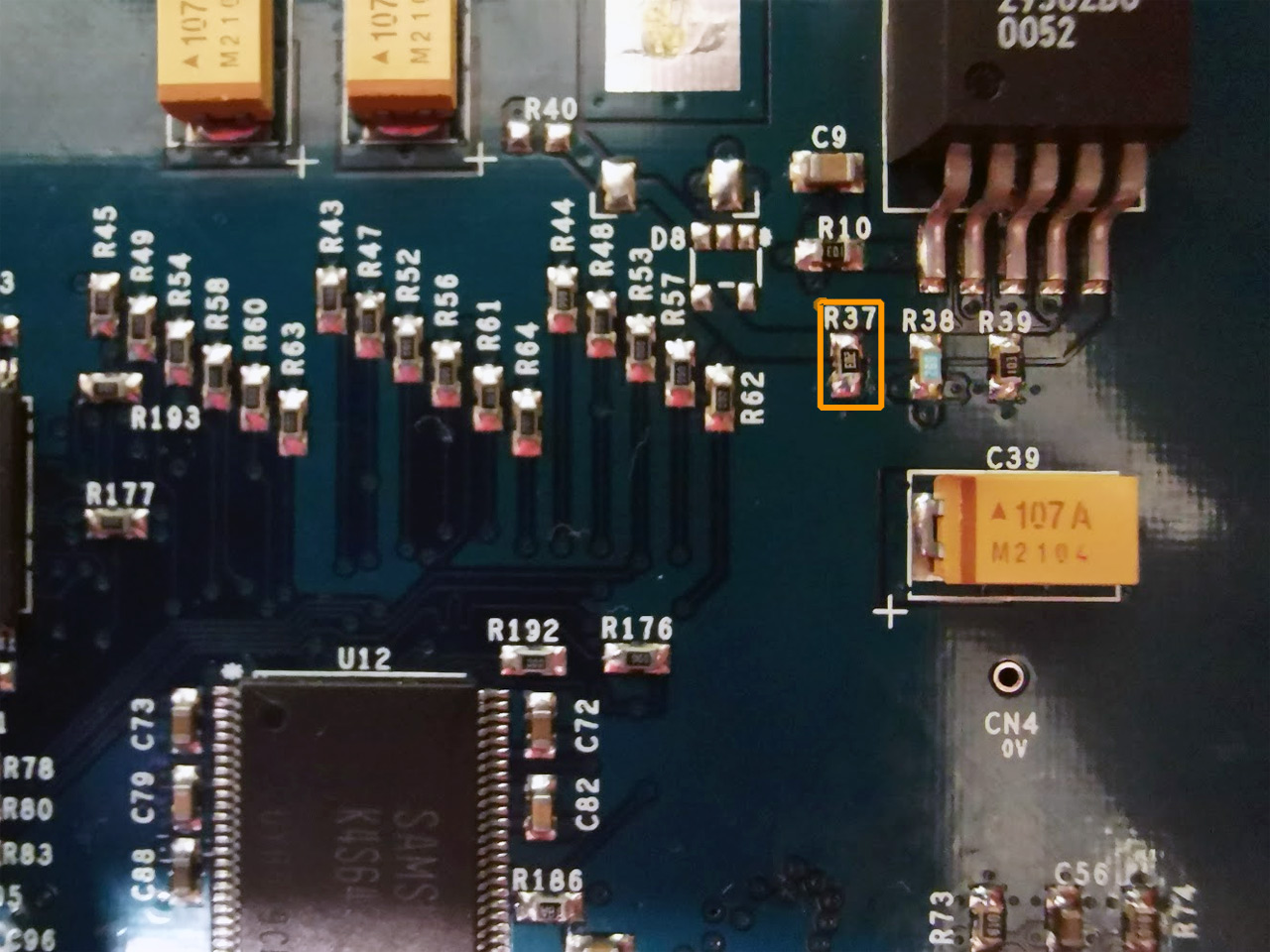

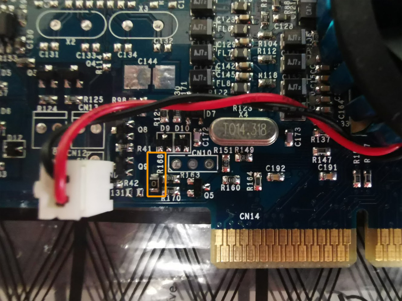

As you can see, there were two areas of the card that needed modifying. R168 near the fan header is bridged to ground (bridges pin A2 on the AGP connector to ground, this tells the motherboard that the card is AGP 4x capable) using a 0 Ohm resistor, and R37 near the voltage regulator was given a 20KOhm resistor in order to raise core voltage from 2.08v to 2.5v.
These things are bloody small! Sure I "could" have used a blob of solder or a bodge wire, but I wanted the card to look somewhat factory and not messed with, this way it's using proper SMD components that look "right".
This one is even smaller, R37 is actually in parallel with R39 here (R38 and R39 form a potential divider which is used as reference voltage for the voltage regulator). Dropping in a 20KOhm resistor on the previously blank pads for R37 drops the resistance of R39, and raises the reference voltage up a tad. This results in 2.5v core rather than the standard 2.08v. Again, could have used a radial resistor and soldered directly between legs 3 (ground) and 5 of the voltage regulator, but this would look ugly as balls, and certainly not passable as "stock".
Hot-air rework stations are a godsend for stuff like this, both the 0Ohm and the 20KOhm were pulled from various bits of dead hardware using the hot-air station, I certainly don't keep such small SMD components lying around!
