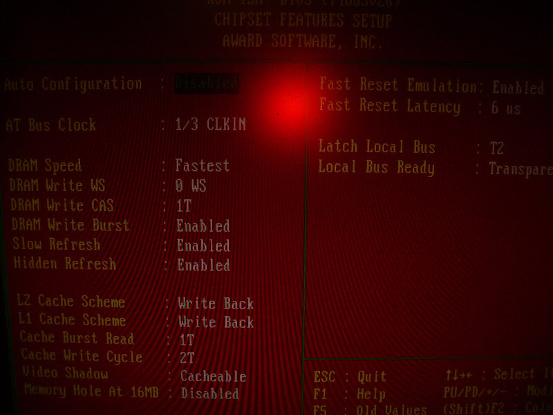

Also, I messed about with the BIOS timings, and I also set the mobo's jumper to VESA wait state = 0, and I can get SpeedSys to score 64.something, which isn't too shabby! I can also get full screen Quake timedemo to score 14.1, which is also fairly good. My best PCI Quake score is 18.3, however. But, if I can get the P75 to run in write-back mode, then these scores will increase.
But the other bit of bad news is that SpeedSys did not show me any reading for L2. I wonder if it has disabled it, because my BIOS timings were too aggressive? Also, on the mobo, I set the "Delay jumper" to "no delay", and the mobo didn't POST, so I set that jumper back to "delay". BTW, this jumper is different to the VESA wait state jumper.

Hmm. Yes, maybe! 😀 I changed the RAM on the mobo, and I also messed about with the BIOS timings a bit more. My full screen Quake timedemo score is now 15.1. It's getting faster! I have a bunch of VLB cards here. I might try them all, and see which ones work at 200 MHz, and also see if they improve the Quake score, or not.
Speedsys - it's quite fast, but no L2. ATM, I don't know why this is.
BIOS timings - I think they are set to their fastest possible?

Edit: I just noticed that if I set the BIOS timings to their slowest values, SpeedSys still does not report any L2 being used. My guess is that the BIOS needs upgrading, before it can work fully with the P75 CPU. I mean, even the online manual from Asus doesn't mention any settings for the P75. I guess this manual was for the original board release, and also I have the original BIOS release.
