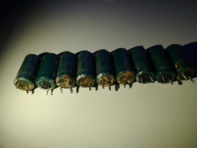

Just received and repaired a KT7A (using a kit from badcaps.net). Strangely all the JACKCON were completely fine, however there were a bunch of "JPCON" that went bad. I changed them all just in case.
The board is not fully working, even after the repair. In particular the keyboard PS/2 port and the parallel port seem dead. However since the BIOS has great support for USB keyboard this is not a huge issue. OTOH the mouse PS/2 and ISA ports are fine.
